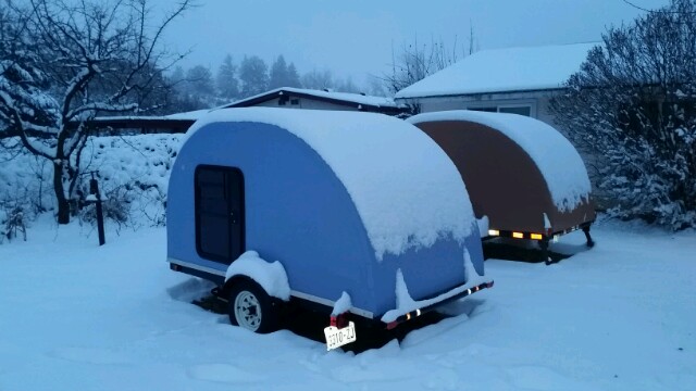

Me and my son slept in the Brown teardrop the Saturday after Thanksgiving last year. It was 10 degrees F. We heated it up at 10 pm and then pulled the heater out and slept till 6 am and it was still about 55 or 60 inside the trailer with just our body heat. I have 4" thick foam on the sealing and the floor and walls are 2"

robhwashington wrote:Me and my son slept in the Brown teardrop the Saturday after Thanksgiving last year. It was 10 degrees F. We heated it up at 10 pm and then pulled the heater out and slept till 6 am and it was still about 55 or 60 inside the trailer with just our body heat. I have 4" thick foam on the sealing and the floor and walls are 2"
4inch thick foam? Wow! What made you decide to use that to build? Thats pretty good heat retention! How big is your build?

I put 4" of foam on the ceiling to give it more strength as there is no wood framing in the brown trailer. Also I camp year round here in central washington and it gets pretty cold in the winter. Originally it was 2" and after it was built I put another 2" on the inside. It heats quickly and stays that way. Another reason I added more insulation is I couldn't figure how to safely heat it in the winter, as I very seldom camp where there is power available. It is a 5 foot by 8 foot trailer and has plenty of room with the extra foam. Also I have a decent sleeping bag that I curl up in till it heats up. Still learning and trying to figure it out, loads of fun though!
