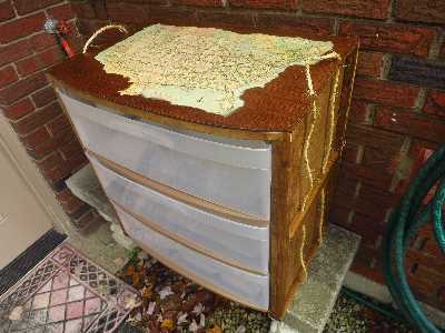

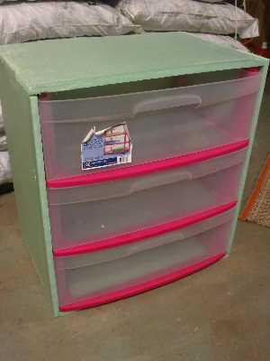

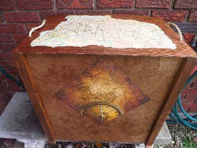

Postby andrew7 » Wed Oct 31, 2018 10:43 pm
I just finished a foamie camp box. Its not hard, just different than wood working. I recommend trying one just as foam practice before getting started. The videos are nice helps to get going.
