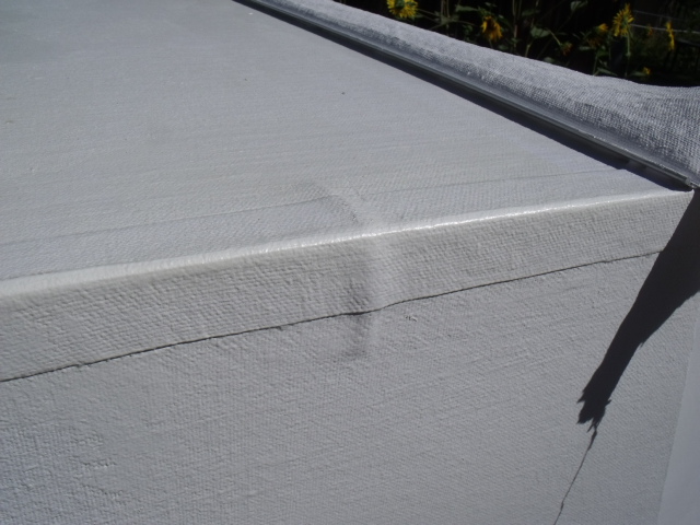

Postby ghcoe » Thu Feb 09, 2017 8:19 pm
I have a few expansion issues with my build. This picture is a point where I had to butt two pieces of dry beading together. I used beading to harden the corners and had to butt a short piece in because the beading length was just a bit too short to go the whole length of the roof. This was taken in the morning and by afternoon it will be nearly unnoticeable.
Expansion
I installed a door in the morning and by mid afternoon it was hitting on the body.
George.
