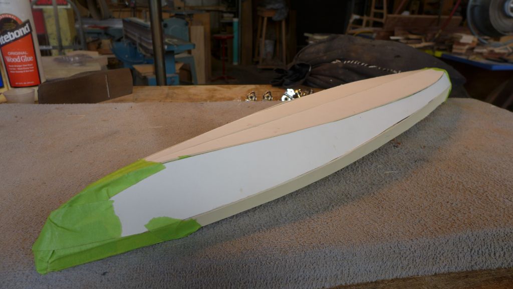

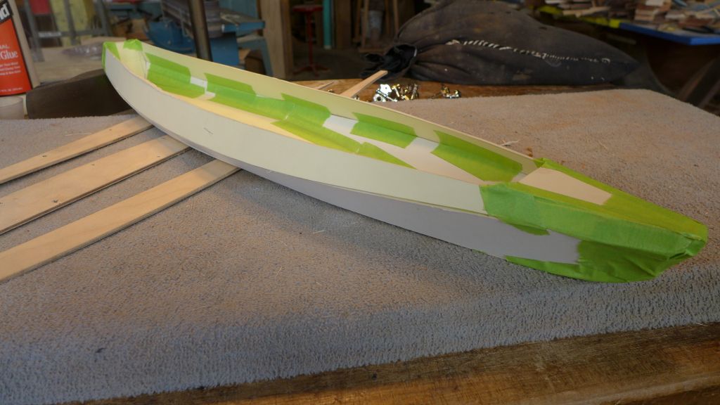

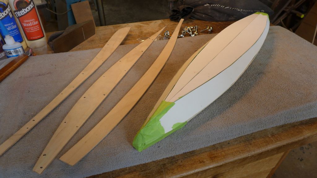

Postby GPW » Thu May 11, 2017 2:13 pm
Went to my buddy’s shop today , saw his scale model of the boat made for the durasip material … he’s got the parts worked out and is ready to CNC the big templates …
And he said if anybody is interested , he'd be glad to share the CNC files with them ... ;)
