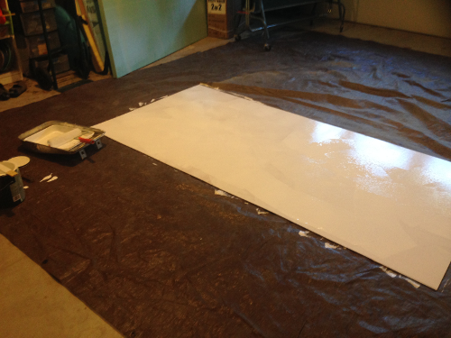

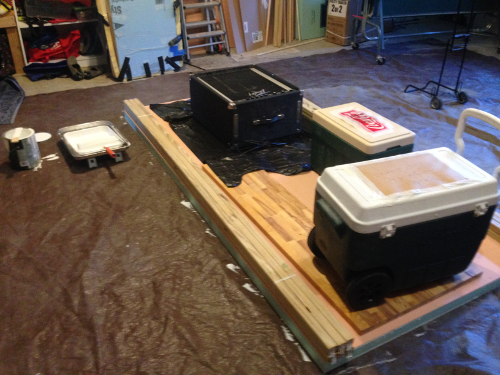

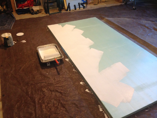

Postby amandacreiglow » Fri Jul 07, 2017 9:12 pm
My canvas arrived today! :D The nice thing about ordering everything for the camper at once is that it feels like christmas every day... just a very specific, trailer-themed christmas.
Attempted to get the floor glued together today. I'm going for a sandwich floor, with two 1/4" ply sheets around one 2" foam panel held with Gripper. I've got it weighted down now, and will see how it turned out when it's done cooking, but I'm not feeling super confident... feeling like I'm going to need to re-do this with a different adhesive. We'll see.
And for the pics:

@QB - thanks for the tip on the youtube videos. I'm not so much nervous about the repacking as much as I am just not really looking forward to it. Will cross that bridge when I come to it. :) I do feel pretty confident, though, about not dealing with curves this build. I do agree they can be cuter, but for this build, for the purposes of learning, I'm just going to keep it straight-line-simple. Depending on how this goes maybe next time I'll go for a pretty curvy build. I'll do my best to bring in the cuteness factor on this one with a snazzy paintjob.
