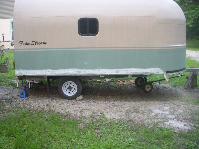

George , first ( and foremost) I blame myself for not using the Mix :duh: …. Then blame the ants , because without those holes , water wouldn’t have gotten in at all … The drip edges did very little after the fact , 'cause the holes were above the drip edge … And then I blame myself again for not fixing them sooner !!! …. even a piece of Gorilla tape as a temporary patch would have prevented all this … (another lesson learned) We make mistakes, we learn from them , and try to prevent them from happening again ( ant Killer ) Thanks for the suggestions , we'll do that !!! :thumbsup:
It appears ( for now) the floor will only be a PIA to remove and not a really Major Project …. We saw that Bonnie cut away a floor ( on our old Foamie #1 ) All by herself too ( bless her ) … so it’s just something we have to deal with … Besides I was finished all my painting commssions and am looking for something to do … Not the most Fun thing to do on summer vacation , but it’s necessary and probably not as bad a job as we can imagine it to be right now !!! :frightened:

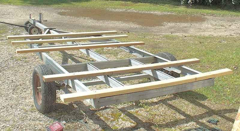

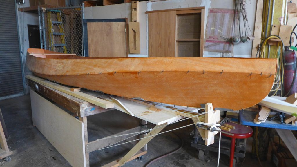

Guys , I’d Love to do a sandwich floor ( Light , Strong ) but I just can’t put any confidence in plywood and these other sheet materials … not living IN the Swamp !!! Now then , my friend at the guitar factory is making a kayak with a fiberglass type sheet material he gets from MS next state over… comes in long rolls and like 96” wide . in three thicknesses , and that would be the stuff I’d like to test on a sandwich floor … ( see pic) … and It’s Not ”That” expensive ... I was waithing for him to finish his Yak , before trying it myself , but maybe if we don’t find some cedar boards we like , we’ll try that … and maybe put some fiberglass "Ant border walls” in under the new canvas… I already talked to the Ant Queen , and she’s going to pay for it … :lol: :lol: :lol:

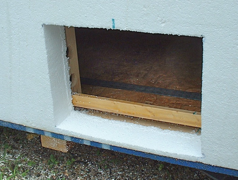

Here’s a pic of the AC hole ,with no drip edge , which shows how the floor ( blue line ) meets the 3.5” thick foam , then the wooden frame inside … ~ 7” to cut through … I guess we’d cut the foam away first , then go inside to cut the sill away … ? Never done this before , a first time for everything .. :NC

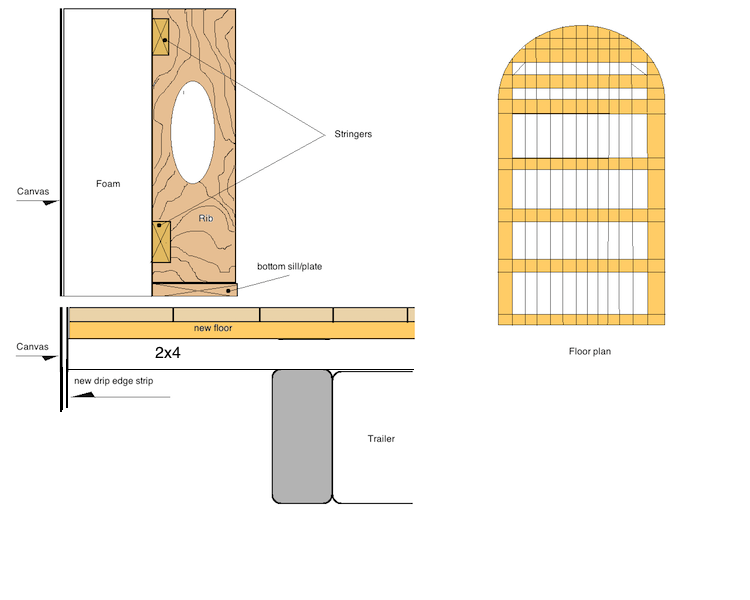

So , while it’ still dark , we re-did the drawing , just so we’d have “ a Plan “ to go by … The new board floor with cross members . We’ll make the new floor on the ground ( shop floor) , slobber it with the Mix , and lift it into place . then bolt it down … I’m assuming the 2X crossmembers are still in good shape ( we’ll check) If not they’ll be replaced . Or maybe even left out … the floor “should” hold the light cabin perimeter , and I could even bolt on some metal L braces to the outer trailer frame … Maybe ?
The heavy drip edges will be replaced by a thin waterproofed strip ( Vinyl ? ) all around and the canvas skin will run straight to the bottom , and Not under this time … no chance water can get near the floor , unless splashed when underway …
And a generous application of Ant killer around wheels and tongue jack … (grrrr!!!)

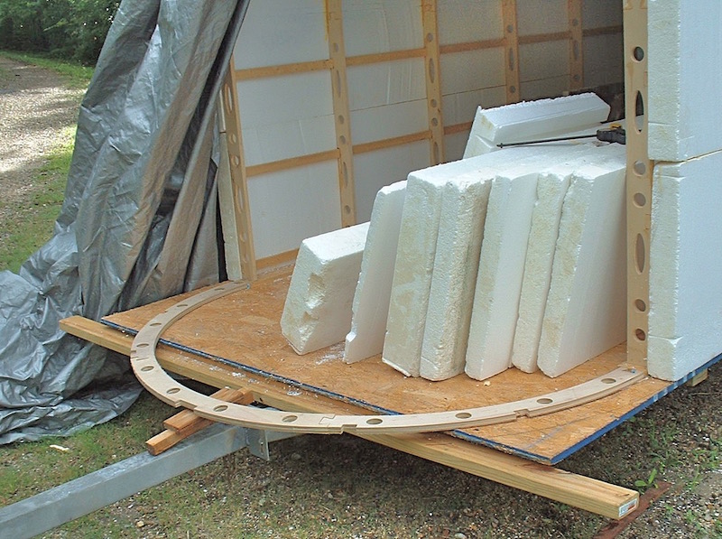

And as a “detail” I’m going to ask my buddy with the CNC to make me a new front rib for the floor /frame… one without lightening holes in it …. all those did was collect dirt , dust and foam beads … :duh:

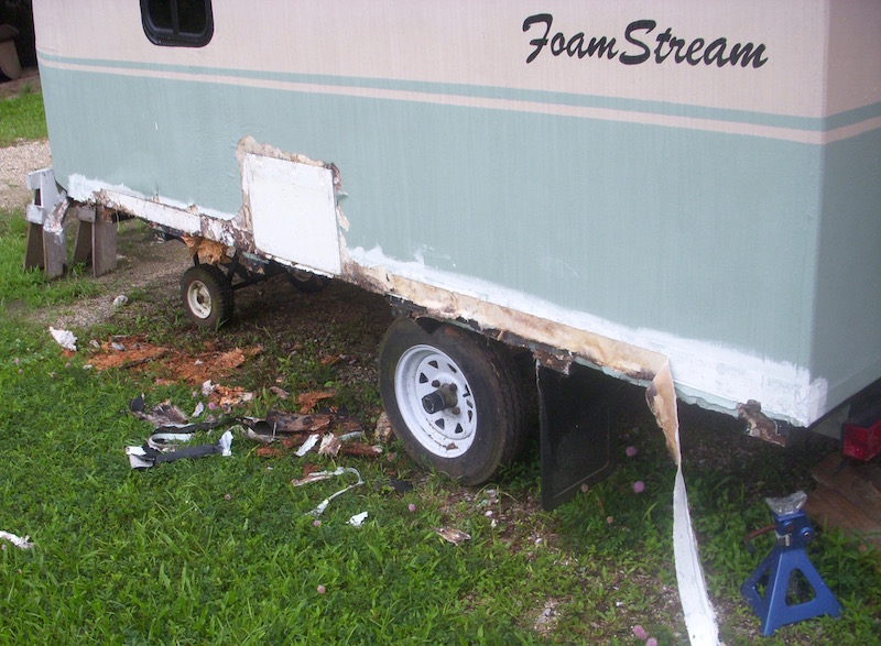

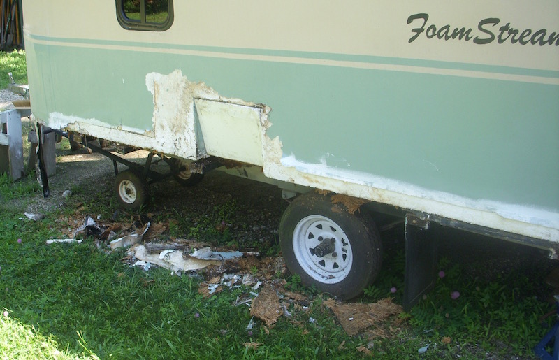

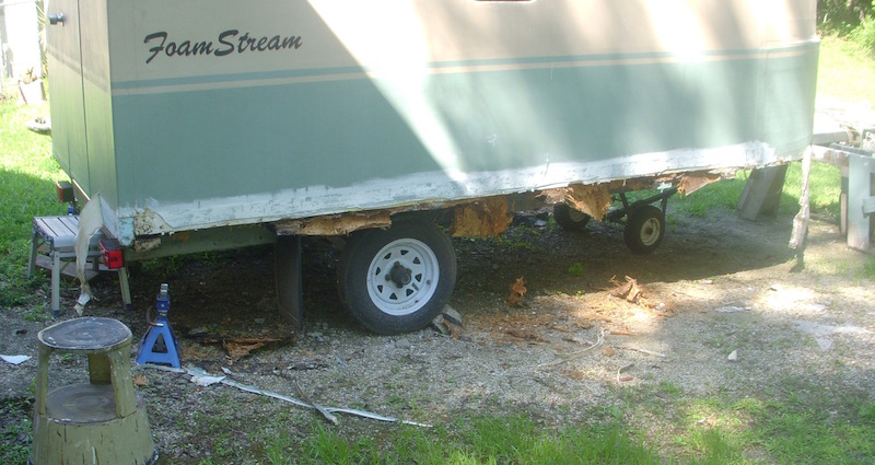

Well then , I thought this would be difficult , but it turned out to be pretty EASY !!! First we removed those new canvas strips , then removed the screws holding the drip edge on , After that I was able to pull the drip edges off . Then taking a drywall saw we attempted to cut away the foam from the flooring … but it was already separated ...and we were easily able to push the saw under the frame too … Great gobs of floor coming off looking like shredded wheat ... :o Apparently everything above the floor was fine , below it was “not so fine “ ... :frightened:
So it looks like it’s not going to be so much trouble to get the cabin off the trailer … It’s not all bad everywhere, but where those ants got in, that floor is gone … What doesn’t come off easily , the sawzall should take care of that ...
Funny in the wetted areas the T2 glue has turned brown and nasty looking , , underneath ,the foam is still as it was in the beginning … we just peel it off and we’re ready to go again …
So it’s not so bad , while being a typical trailer floor disaster…
Here’s pics of the Ant side and the good side …
Re: FoamStream , the restoration … a lesson learned .
Postby GPW » Thu Jun 07, 2018 9:52 am

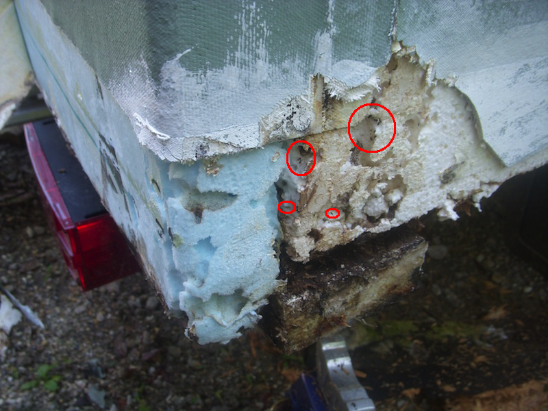

Just a little more poking around we can see it wasn’t only the ants , although we did still find them in the trailer ( they’re the little bitty TINY ones… see pic ) and they tunnel through the foam for a condo ... :o Looks like the drip edges added as an afterthought were added too late … Water damage from fabric wrapped under the floor pretty much rotted out everything … Under all the nastiness the Foam seems fine ( save where the little A holes tunneled through it … ) :x
Three things we will do in the future …
1. Not wrap fabric around underneath without really making SURE it’s waterproofed …
2. Make sure we have drip edges installed from the start .
3. Bring and use some ant spray … grrrr!!! Little bas***** !!!

Little ants , so small you can’t see them … they did all this … (circled in red)
