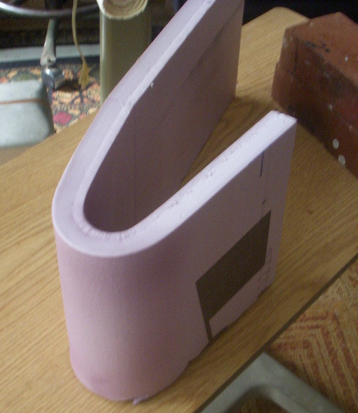

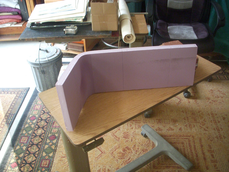

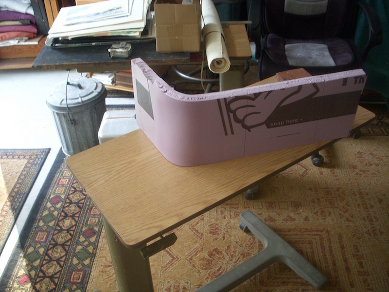

... since we will only be bending in small increments at a time ( creating a much larger curve, small bend by small bend bend ) we only need to heat a little area of the Foam and in that area only the top and bottom surfaces … The middle of the foam doesn’t feel the full tension and compression forces and being thnner , just goes along with the bend …The top (outside of the curve is being stretched , the inner curve (inside is being shoved together , or compressed) Just a little heat makes this process easier .
...and then it cools completely in a minute , no waiting … stays bent in that shape permanently .
Just a couple cheapest Harbor Freight heat guns and a “bending jig” is all we need … And as soon as I get the FoamStream repairs finished, I’m going to make a jig for bending 1” & 2” foam , and a You Tube video of the process … ( bending 1” will be EASY )
Anyone wanting to test this without much investment , just lay a piece of foam over a table edge , heat along that edge with a heat gun ( or a kettle of boiling water = 212F ) and apply pressure to the outer end till it bends where you want … hold it there till it cools … and then you’re done … If you mark the foam with a line across every few inches, and bend slightly at each mark , you end up with a nice Curve …
Trust me , once you bend your first piece of foam to the shape you want , you’ll see how easy and quick it is , and with no mess to clean up or track in the house …( and have to clean that up too)… It does take some help , but it is Not difficult .
I know all this seems as incredible as the original idea of someone making a camper trailer out of foam ( we know that works, now ;) )… but if we all work through this , well be able to essentially build any shape we want …

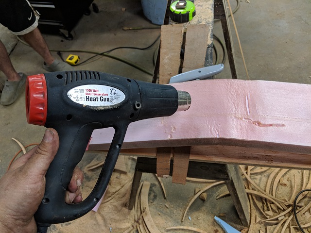

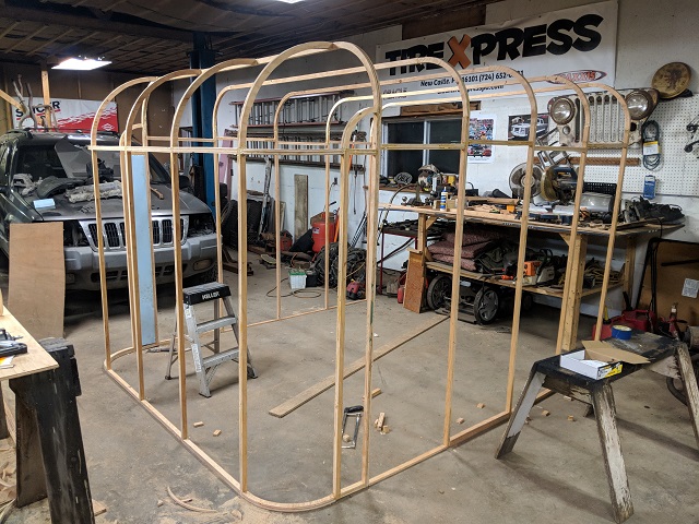

Postby DaddyJeep » Thu Aug 16, 2018 10:03 am
GPW wrote:( bending 1” will be EASY )
I did my first test of this process last night and was not blown away at how easy it was. My camper has a radius all the way around the edges so I will need to bend a fair amount of 1" foam.
The spacing between my framing is 21" - 23" so that is the size of piece I will be bending. Maybe picking up a second heat gun will help instead of going back and forth. I am anxious to see your video of how easy it is to bend 1" foam GPW. :R

Postby GPW » Thu Aug 16, 2018 4:05 pm
I just keep the gun moving backing forth with an eye on the surface … any melting (shininess) or bubbling means we’re too close or not moving fast enough … but then again , we’re only heating a small line across the foam , not a large area which would be subject to the science "a guy” was talking about … ^

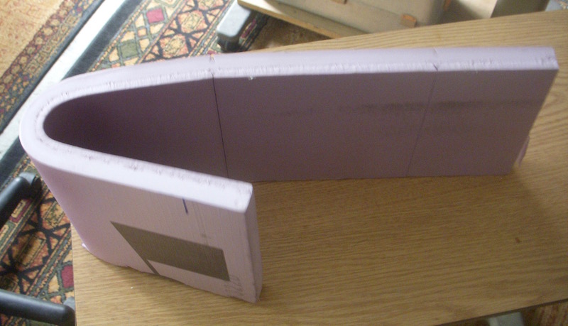

“You are just going to have to show us how it can be done.” …. https://youtu.be/5WVKttqb6HQ ;)
Re: Let’s Heat bend Foam … Please !!! No more kerfing ...
Postby GPW » Fri Aug 17, 2018 8:41 am
… and to the extreme … sorry about the low rez video , new camera … :duh:
Any questions ???
Postby Homebrewer25 » Fri Aug 17, 2018 9:35 am
Looks pretty easy, but what would be your approach to bending a 60" wide piece of 2" thick foam?
It seems that as you pass back and forth over that width there would be significant heat loss and would take a long time to get hot enough (if ever :) ).
It's 5 o'clock somewhere ... time for a :beer:
Steve
Foam Ranger Build (postponed by COVID - resuming spring 2021): http://www.tnttt.com/viewtopic.php?f=50&t=70159
Homebrewer25
Posts: 114
Images: 19
Joined: Thu Aug 18, 2016 4:08 pm
Location: Flag Pond, TN
Postby GPW » Fri Aug 17, 2018 10:51 am
You’ve seen it !!!!
For big sheets … Two people with heat guns , one on top ,one on the bottom , despite what you think it will do , you can obviously see it will bend , that’s just with a little 1000Watt hobby heat gun … Then you need one person doing the pushing/bending … 3 people … That’s why it may require the help of friends or family for big sheets … ( and a little PRACTICE handling a heat gun or you’ll surely scorch it if you’re not paying attention... :frightened: )
The whole secret is to not be greedy or rushed and try to do too much at one time ( a No No ) …. you can actually FEEL it letting go , bending a little at a time … With two people heating top and bottom simultaneously it will go much quicker…
Now what to do with this 1” foam Taco … ??? :o
Watch the video … https://youtu.be/5WVKttqb6HQ

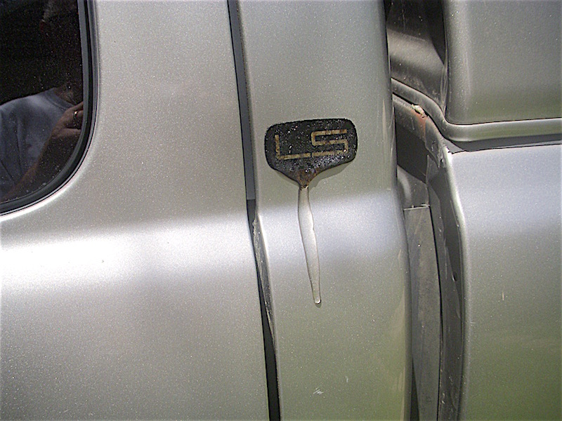

Postby GPW » Fri Aug 17, 2018 10:59 am
Now I don’t know about heat loss in TN , but here in LA it’s Hot as Heck , my pickup truck emblem melting ... :frightened: There’s NO heat loss here … :sweaty: Maybe don’t even need a heat gun . :thinking:
