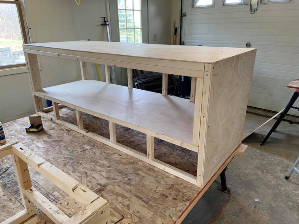

Postby stharding1836 » Thu Apr 11, 2019 8:21 am
Got some work done on the new bunk bed.
New Bunk bed.jpg (73.66 KiB) Viewed 1792 times

Re: Bunk bed question
Postby KCStudly » Thu Apr 11, 2019 10:34 am
That looks to be a fair bit lighter. :thumbsup:
Postby stharding1836 » Thu Apr 11, 2019 1:29 pm
KCStudly wrote:That looks to be a fair bit lighter. :thumbsup:
It really is, I can pick it up by myself.
Postby GPW » Fri Apr 12, 2019 4:43 am
NICE !!! Looks simpler too … :thumbsup: 8)
Postby stharding1836 » Fri Apr 12, 2019 7:28 am
GPW wrote:NICE !!! Looks simpler too … :thumbsup: 8)
Thanks, it really was.

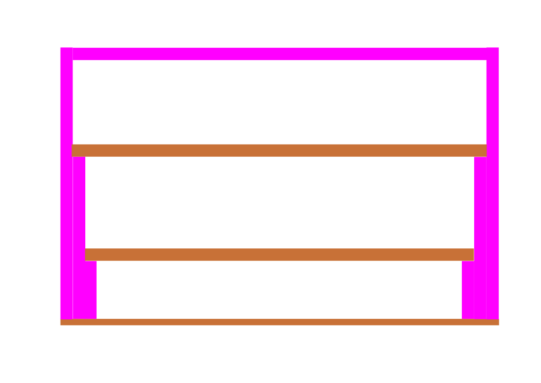

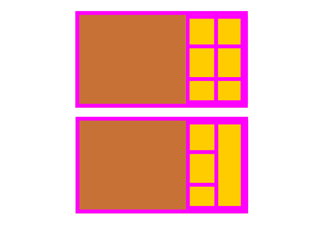

Postby ghcoe » Sun Apr 14, 2019 7:58 am
Seems I am a bit late here, but though I would post this up for future reference.
My idea on bunk support is this. Since foam has a lot of compression strength you could stack the foam against the wall in the bunk area as pictured. Then you can lay your bunk frame on top of the foam edge created by stacking. If you are working with limited width it won't work, but if you have plenty of width then this should work.
Also, to save weight on the lower bunk you can install foam supports and just add a piece of OSB/plywood to the top, unless you want that extra long storage space. You could make convenient pockets for storage of clothing or other things. A couple of ideas. George.
Bed Supports shown.png (6.13 KiB) Viewed 1667 times
George.
