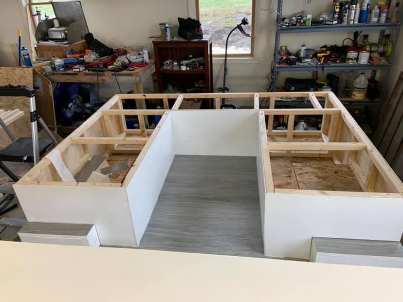

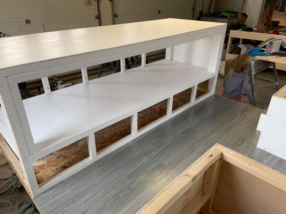

Postby stharding1836 » Thu Apr 18, 2019 12:59 pm
Got the flooring down and I painted the furniture.

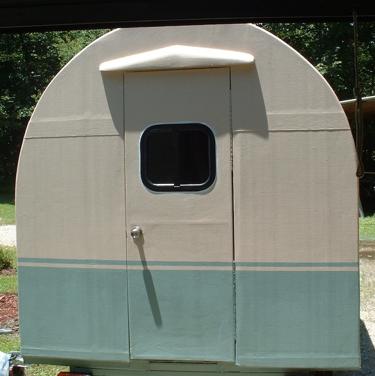

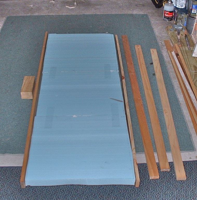

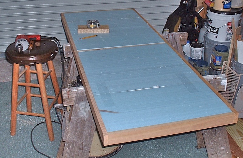

Postby GPW » Tue Apr 23, 2019 5:17 am
You may want to try Foam with wood edges …
Re: My First Foamie
Postby stharding1836 » Tue Apr 23, 2019 9:29 am
GPW wrote:You may want to try Foam with wood edges …
I was thinking of something similar. I think I might try the foam with wooden edges, but also sandwich the foam between two pieces of 1/4 ply with the outer piece having about an inch overlap all the way around. Then just attach some weather stripping to the inside of that for a seal.

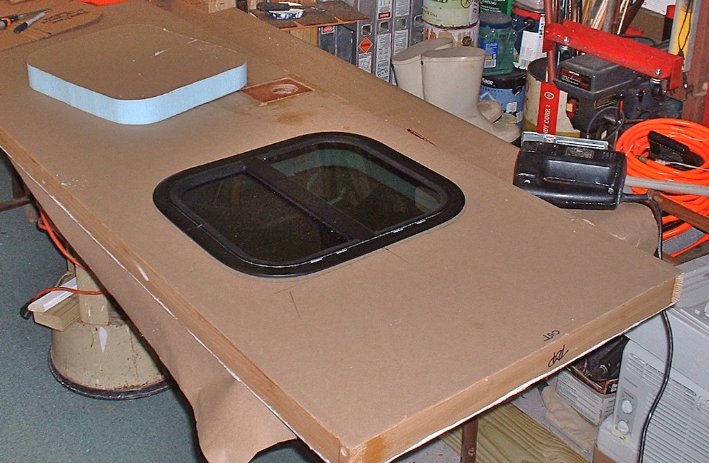

Re: My First Foamie
Postby GPW » Thu Apr 25, 2019 5:22 am
..we covered over the foam and wood edges with a heavy Kraft paper , then added the canvas and paint over that … 6 years and counting living outside ... :thumbsup:

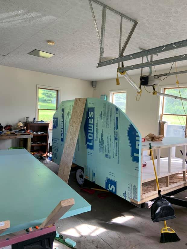

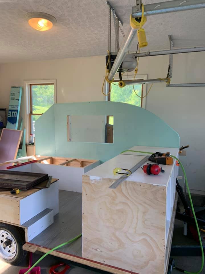

Postby stharding1836 » Mon Jun 03, 2019 7:48 am
I've got one wall cut out. It's not glued up yet, I just wanted to see what it looked like.

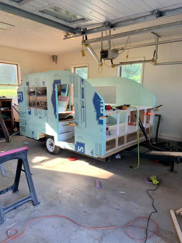

Postby stharding1836 » Fri Jun 07, 2019 7:37 am
I got the windows and the door cut out, and I have one wall glued up.
Walls 2.jpg (56.51 KiB) Viewed 2363 times
Walls 1.jpg (57.7 KiB) Viewed 2363 times
