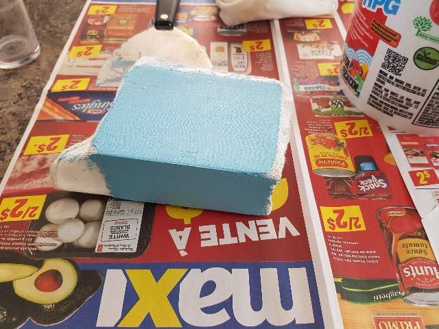

So you're probably gonna think I'm crazy with all these ideas but I've got another test going... I was thinking about the point of elasticity that was brought up and I remembered tiling my walk in shower a few years back.
I used a product called mapelastic HPG to seal the concrete backer board before installing my porcelain tiles. It's basically like really thick paint that turns into a very flexible rubber membrane once dry. I remember the stuff being just awesome and after a peek in my basement sure enough I have most of the second gallon I purchased leftover.
The stuff is really quite expensive so there's little chance I will use it to coat the trailer but I wanted to give it a try anyway. If it works well maybe I will do the interior of the wet bath with the gallon I have left.

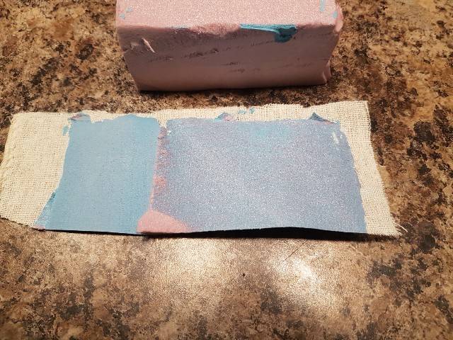

First test of the Mapelastic HPG. I cut the sample in half because I want to see how paint will adhere to the cured membrane. Below are pics of the separation test, it was hard to peel off and there is foam particles embedded in the membrane after removal.
Only 1 real chunk of foam was ripped out as the side was ripped off in more of a shear motion that peeling. I would bet that a deeper sanding of the surface would improve the bond even more. This piece was only lightly scuffed with some mesh drywall sandpaper.
In the application manual for the product they note that fiberglass mesh can be embedded in the membrane for strength and to improve out of plane movement resistance. Fiberglass mesh for door screens can be purchased very cheap and I've got some laying around so that will be the next test.
This stuff is over $60 Cdn a gallon and they state that at 1mm thickness it should cover 40sqft so unless I can find a better price and buy 5 gallon buckets, this stuff will only be used for the wet bath walls.
For those of you who have been using TB2, what kind of coverage were you getting per gallon? Not for one coat but for the finished PMF panel. This info will help me make a decision.

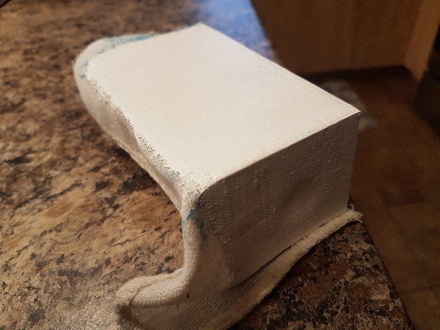

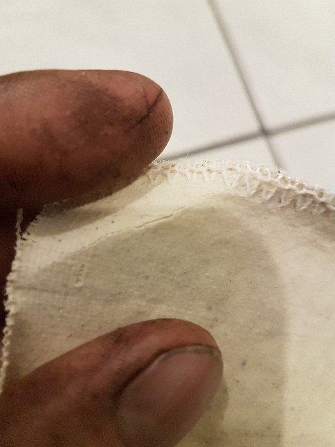

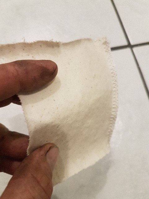

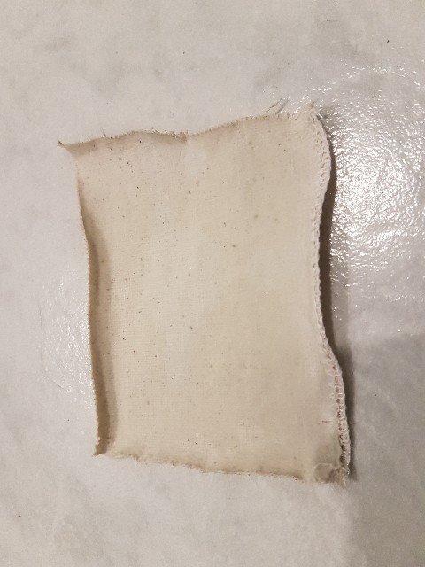

So back to the original topic, the durapro adhesive. The flexibility test piece is now dry. The answer to the question is that it really is quite flexible when saturated into the canvas. I was able to bend it back and forth with no problems. If you make a sharp 180 degree bend it will crack however but I'm not sure there's any material that wouldn't.
This stuff is moving back into my list of possibilities. I really like the idea of using a liquid waterproofing membrane embedded with either fiberglass mesh or geotextile but it would be far cheaper to go this way with regular canvas and exterior acrylic paint.
I think I'll throw a coat of paint on this and set it aside with the painted mapelastic hpg sample.

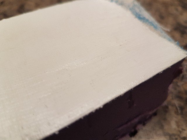

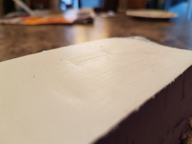

Painted Mapelastic HPG sample is done!
All I can say about this stuff is WOW. I put two coats of acrylic exterior paint over the blue membrane and let it dry. A peel test of the side corner showed the same excellent bond to the XPS as before. I then started gently scratching the surface with my fingernail to see if the paint would peel showing the blue membrane, it did not.
Then I started getting rough trying really hard to peel the paint with my fingernail until I bent my nail backwards (ouch). Then I got mad and started at it with a butter knife in a scraping motion, nothing again. Then I started hammering it with the handle of the knife and only light surface dents where the foam had compressed underneath without harming the membrane.
I am really impressed and this is definitely the product I will coat the interior of my wet bath with. If the liquid rubber samples I receive demonstrate the same qualities then I will be ordering 5 gal of it with the geotextile they suggested to coat the exterior of the trailer.

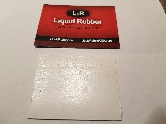

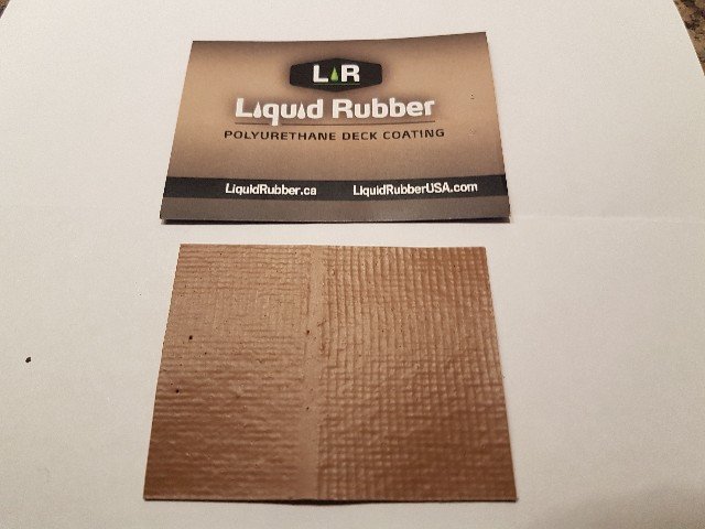

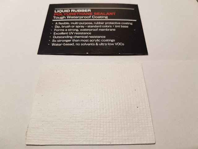

Liquid Rubber samples are here!
As promised I received the polyurethane liquid membranes from Trevor at Liquid Rubber. The samples are very tough and remind me of stiff synthetic leather.
The white sample is PU-100 and supposedly has a 400% elasticity rating. It is noticeably more flexible than the deck coating. The geotextile embedded in the membrane is more visible on one side than the other. After careful examination I believe the more textured side with small air bubbles visible in the surface is the outside. I have emailed Trevor to confirm this, I would rather have a surface finish like the other side where the geotextile can barely be seen and there are no surface imperfections but I will find out from Trevor if this is possible
The brown sample is the deck coating and there is a visible seam where there is no geotextile embedded for about an eighth of an inch. I'm not sure if this was on purpose to demonstrate the products inherent strength even without the embedded geotextile or not. This product claims 200% elasticity and it can literally be creased over onto itself and not crack. Stretching it at the seam where there is no geotextile is possible and it does recover its shape once tension is released. Once again the embedded geotextile is still visible in what I suspect is the surface finish but there are far fewer imperfections from air bubbles.
Both samples are very scratch resistant and only metal objects seem to leave any marks.
I will let you know more when Trevor gets back to me about which surface is actually the outside. So what do you guys think?

Postby John61CT » Wed Feb 27, 2019 8:27 pm
To me checks out great, as an outermost UV / waterproofing layer.
As for gluing canvas or embedding direct into foam, who knows, you'd need to test.
Cost likely much higher compared to Gripper then oopsie paint, but obviously not your top priority.
Be the pioneer!
