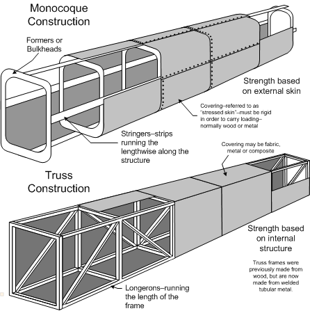

Now then , taking a note from the Tipi, Fabric stretched over a frame ( sounds like a Tent eh ? ) and with an inner liner to allow an air space in between ( insulation) , that idea could be applied to a trailer built “similarly” to an aircraft fuselage ( formers and stringers ) with an inner and outer skin … You could make the frame any shape you wanted that way … or even an EGG ;)
The problem is most of these methods would require a lot of labor … even just cutting saplings and bending them to shape as a frame would take a good bit of effort to get "just right" … :o Ther Old Timers steam bent Hickory or Ash to make Bows for their wagons … same process could be used for formers … Lots of possibilities … Could be Fun !!!
fuselage frame .jpg (9.4 KiB) Viewed 3739 times
Construction Types.gif (35.35 KiB) Viewed 3739 times

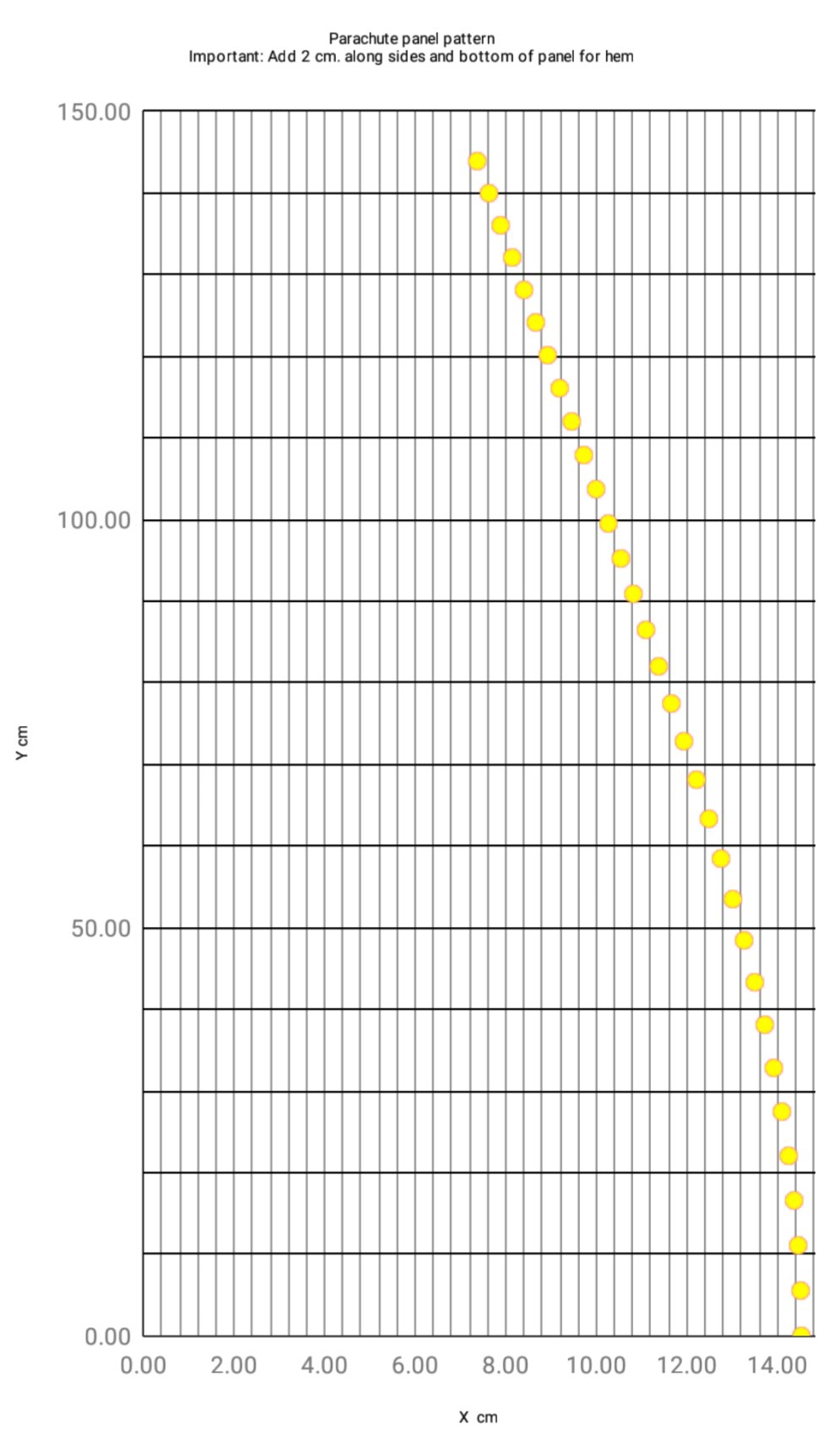

VTSteve wrote:Or you could use this free software from Carlson design. It is limited and geared toward boat design but it might work.
http://carlsondesign.com/projects/hull-designer/
Very cool, thanks
> Dealing with cutting "gores" is another thing though. I define a gore as a triangular "v" cut in flat material that is used to get a material to wrap around a corner or compound curve.
Well not triangular. The parachute XLS outputs this curve for a semi-ellipsoid, similar to a flattened hemisphere, with a minor/major axis ratio of 0.707, 222cm diameter and made up of 48 gores.
Also an example from a kid's globe project.
John61CT

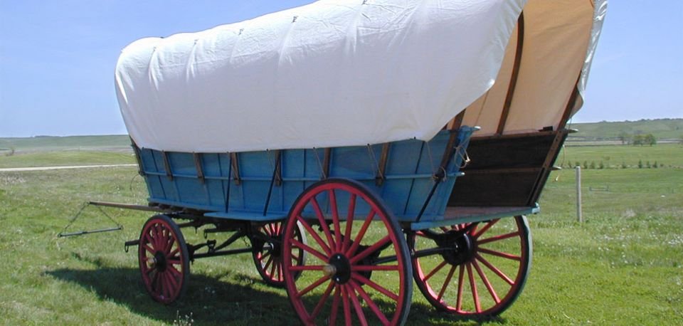

Re: Rolling wigwam /organic vardo/geodesic
Postby John61CT » Wed Oct 28, 2020 1:10 am
Another well of inspiring shapes, covered wagons
needs adapting to aerodynamic slipstreaming needs
but could easily be made light enough to raise & lower
John61CT
