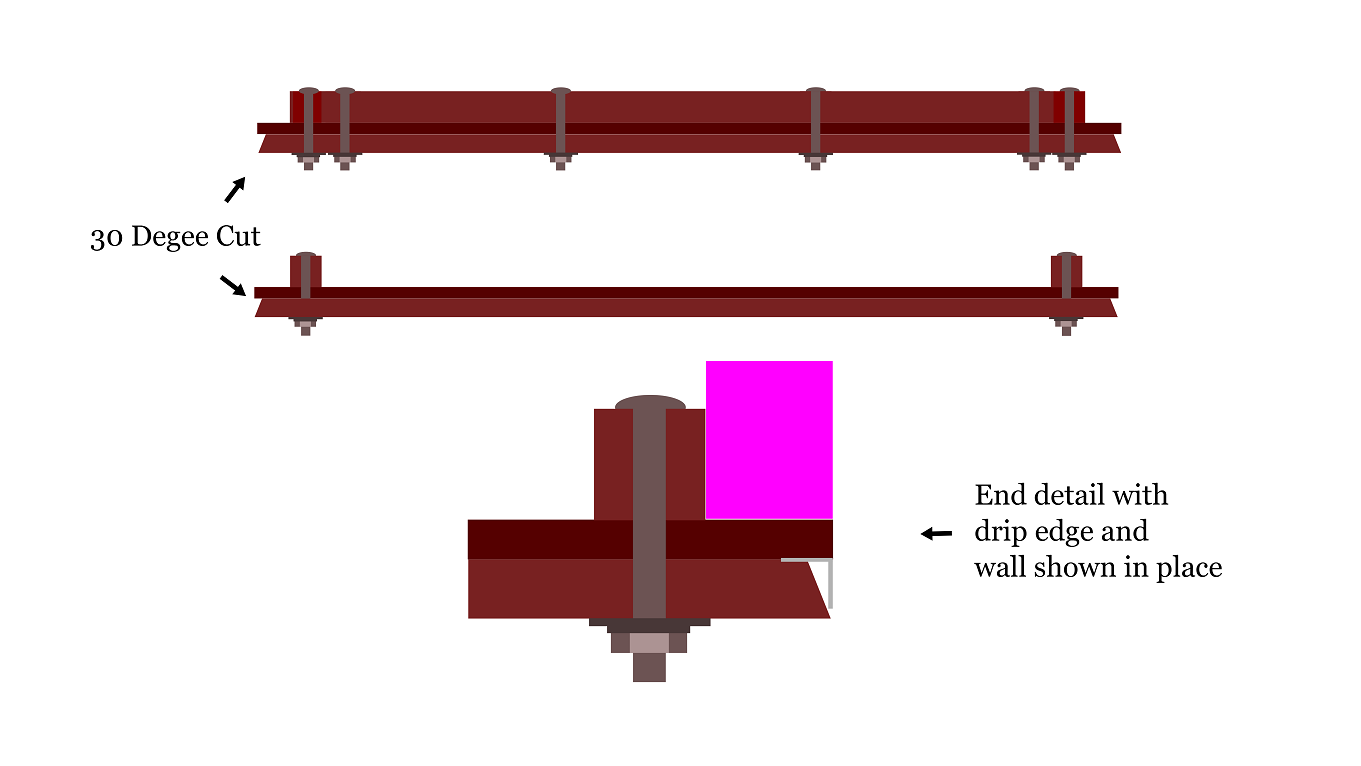

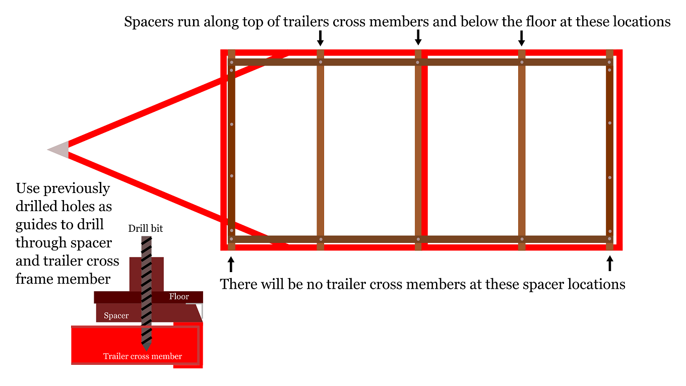

Postby ghcoe » Sat Apr 20, 2019 8:27 am
I attached my trailer at the trailer cross members in the middle and at the ends made a piece of wood that fit snuggly between the outside frame members. Then I bolted through that, it created a clamping effect of the frame. Seems to be working out just fine so far and I am harder on this trailer than most.
Installing Floor Spacers s.png (88.82 KiB) Viewed 3385 times
Floor Spacers s.png (35.89 KiB) Viewed 3385 times
George.
