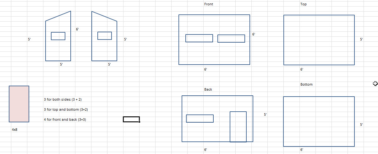

What is the recommendation for sandwiched floor as far as what size plywood to use? Is foam bottom, then topped with 3/8 plywood strong enough? As mentioned before, all of it wrapped in one big "sock".
I took a screenshot of my quick dimension drawings. These are rough drawings just to give me estimate on how many foam boards to buy.

Petero58 wrote:What is the recommendation for sandwiched floor as far as what size plywood to use? Is foam bottom, then topped with 3/8 plywood strong enough? As mentioned before, all of it wrapped in one big "sock".
You need to have plywood skins top and bottom of the foam core properly glued and screwed to internal and perimeter boards. How thick the skins need to be depends on how thick the core is and how far you need to span. How tall is the stand and will it have joints to carry the live loads on the floor or will the floor have to span the full five feet?

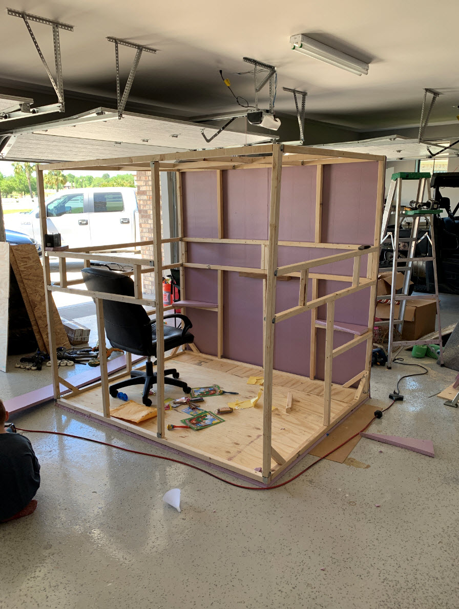

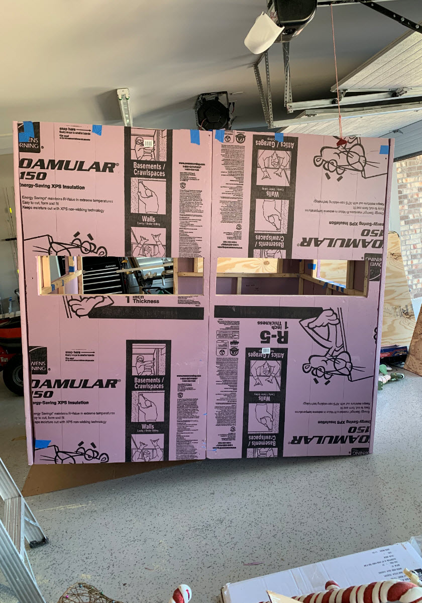

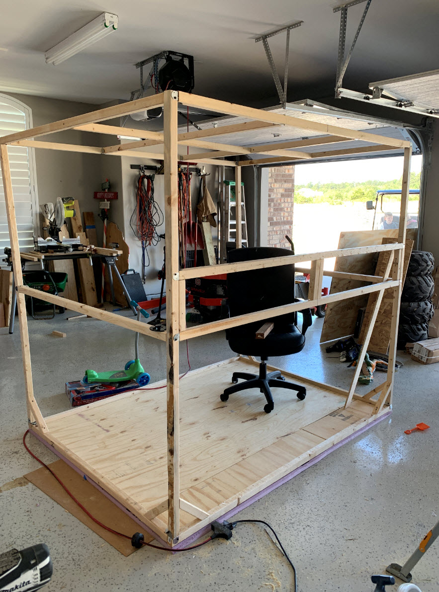

Postby Petero58 » Mon Apr 22, 2019 6:37 am
Here are the progress pics so far. I was able to get the roof on last night. Gorrilla glue and painters tape to hold the join for now.
I will pick up some great stuff foam today and get the corners real good and then sand the corners tomorrow. I am thinking about rounding off all the square edges just for looks, but not sure yet.
Stand 3.jpg (220.31 KiB) Viewed 1037 times
Stand 2.jpg (250.05 KiB) Viewed 1037 times
Stand 1.jpg (264.09 KiB) Viewed 1037 times

Re: Deer Blind
Postby Petero58 » Mon Apr 22, 2019 9:07 pm
Any recommendations for sanding and rounding the hard edges a bit? Tried my orbital sander but the foam seems to be too soft and not easy to get a steady finish.
May try my rotary tool tomorrow.
