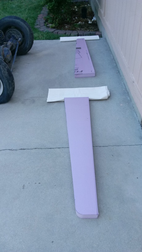

Sunday morning, 2am, I got an idea for a way to apply TB2 to make it stick better to Foam.
First I prepped the foam as always, light sanding and a few dimples put in the foam. I put full strength TB2 on it and made sure it filled the dimples and I had a very thin coat on the rest of the board.

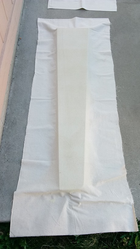

I then took a piece of canvas and soaked it with TB2 80/20 mix. and hung it up to dry over night.
159340
After 10 hours of dry time, the board was tacky and the canvas was damp. I took a little more TB2 80/20 mix and put a thin coat on the board. I then put the piece of canvas over it and pressed it down well with a roller.

I think that the key to getting our best adhesion is to coat the foam and the canvas first, whether it's with TB2 or primer and letting it dry for a short period of time, then using a little more glue or primer, and then put the canvas to the board.
