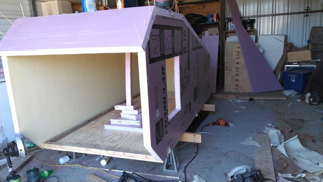

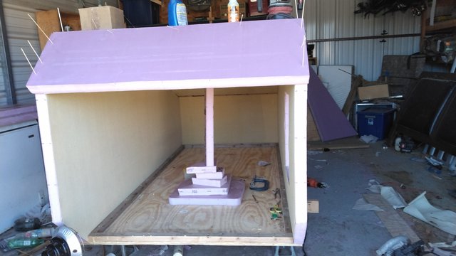

Started gluing parts together

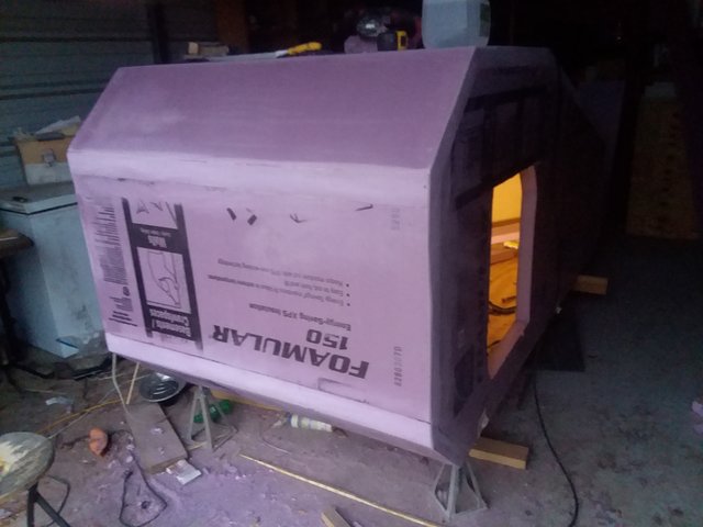

Postby Tx River Rat » Wed Dec 18, 2019 2:12 pm
It is starting to shape up

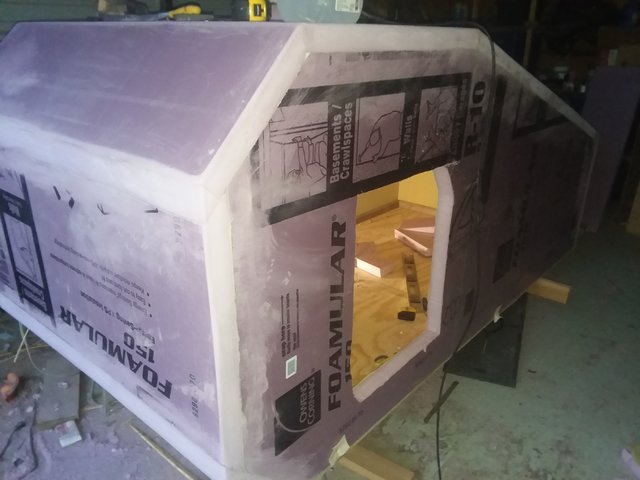

Postby Tx River Rat » Fri Dec 20, 2019 6:37 pm
ALL GLUED UP NOW JUST A LOT OF SANDING

Postby Tx River Rat » Fri Dec 20, 2019 6:39 pm
i PUT A HAIR DRYER INSIDE FOR FEW MINIUTES GOT WARM AS TOAST

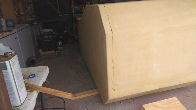

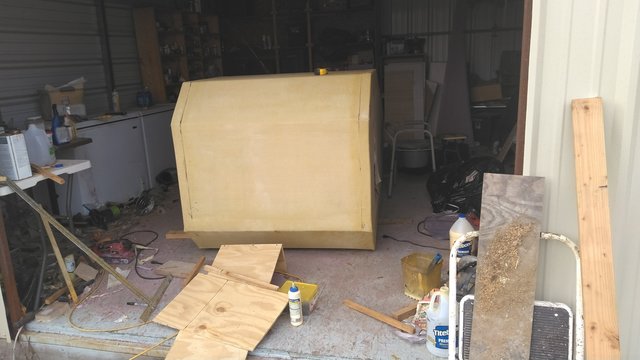

Postby Tx River Rat » Mon Dec 30, 2019 11:41 pm
outside covered and sanded ,its ready for paint
