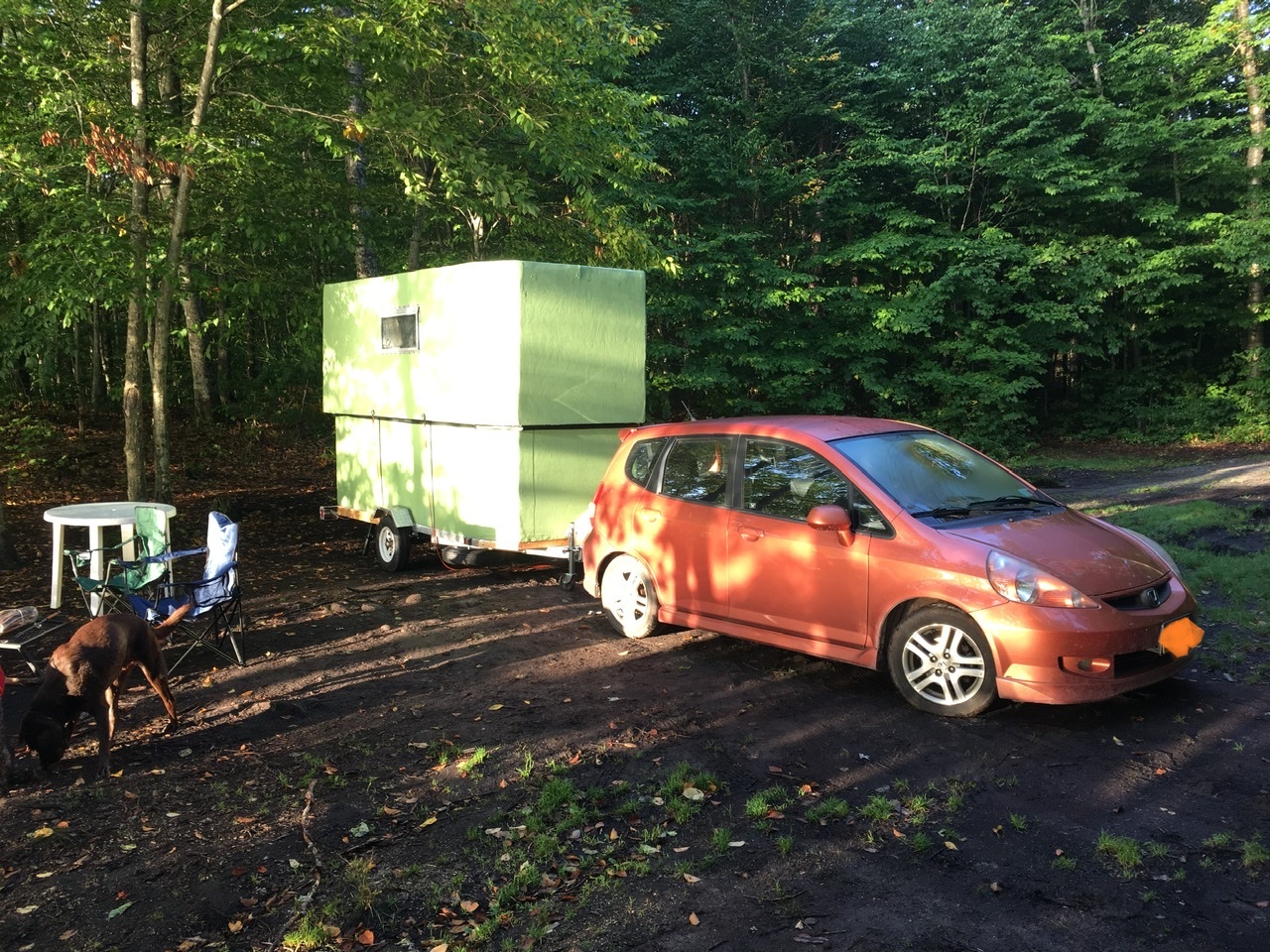

Postby Tyrtill » Wed Mar 25, 2020 4:40 pm
My camper is about 5x11 and weighs 1030lbs with a full tank of diesel and 6 gallons of water so 750 should be very achievable. If I were to rebuild mine a could probably cut 150lbs of it without sacrificing anything.
I'm really tempted to build a non popup version in the future which would save more weight and be way easier to build but might be a sail when driving.
