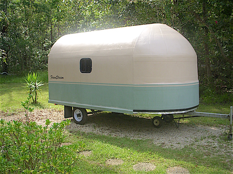

Postby GPW » Fri Jan 31, 2020 1:05 pm
Note: PMF doesn’t have to be UGLY … 8)
FS repaint2.jpg (274.89 KiB) Viewed 1791 times
Re: Fiberglass over XPS
Postby JazzVinyl » Fri Jan 31, 2020 8:38 pm
GPW wrote:Note: PMF doesn’t have to be UGLY … 8)
Yep! That looks really nice!
JazzVinyl
Posts: 167
Images: 211
Joined: Wed Mar 27, 2019 2:30 am
Postby GPW » Sat Feb 01, 2020 5:58 am
JV, best of all , it’s lasted 7 years ( living Outside ) and no signs of giving up yet !!! :thumbsup:
