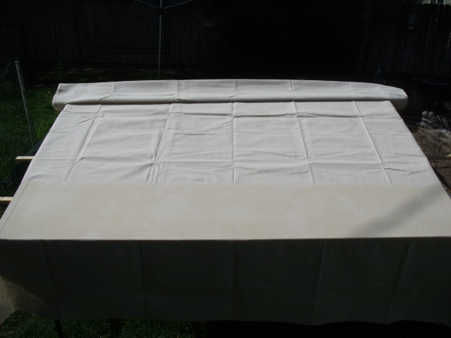

Primer is usually not waterproof. It is more like a real water down filler like spackle. It is porous so paint will bond to it well.
I find the 50/50 mixed TBII penetrates the canvas well on both sides so you don't have to worry about canvas rot. Also, this wets out the canvas and allows it to relax and lay flat. I don't preshrink my canvas so with wetting it out and with the natural shrinking I can get a nice smooth finish. Something that I think would be hard to do with applying canvas with paint/primer.
