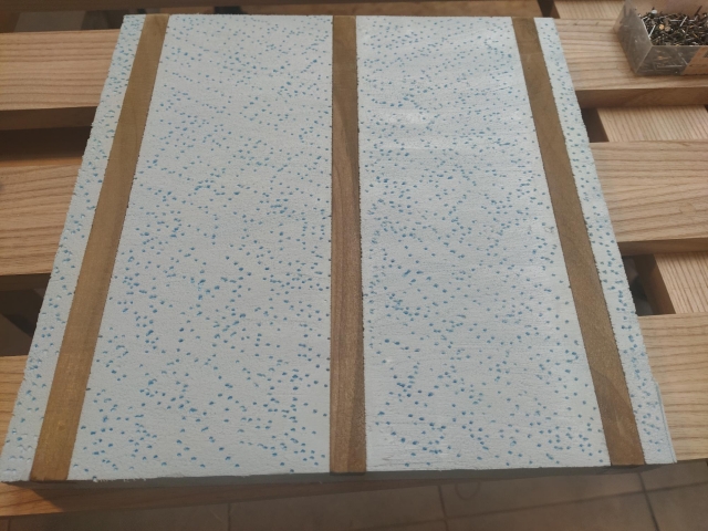

This is a test piece i made. The 'nailers' are routed and epoxied into the foam. The strips planking is epoxied and nailed perpendicular to the 'nailers', creating a lattice inside the foam. After curing nails are removed and toothpicks fill the nail holes in the strip planking. All is sandwiched between fiberglass inside and out. I stood on the test piece, which is only 35mm thick and it didn't deflect one bit. The clamping battens can be screwed through nailers and foam to floor cleats while the polyurethane cures.
The finished trailer will be ridden to location and left there. It will not be used for travelling as such.
