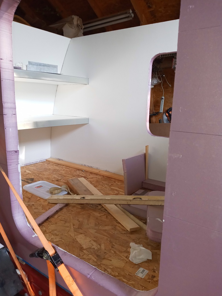

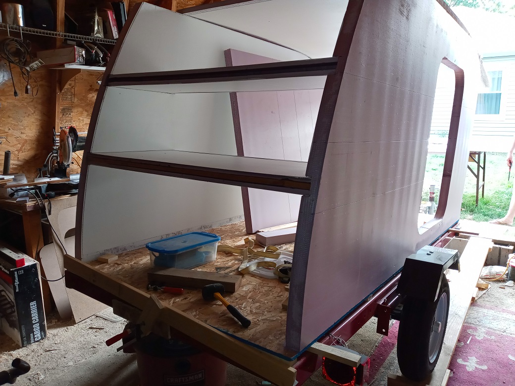

I got the shelves cut and installed into the rear dado cuts.
rear shelves
20200906_171115 s.jpg (281.03 KiB) Viewed 2204 times
Then I glued the inside rear wall skin onto the sidewalls.
rear wall inside skin
20200907_090743 s.jpg (245.97 KiB) Viewed 2204 times
rear wall inside skin #2
20200907_090805 s.jpg (314.48 KiB) Viewed 2204 times
George.

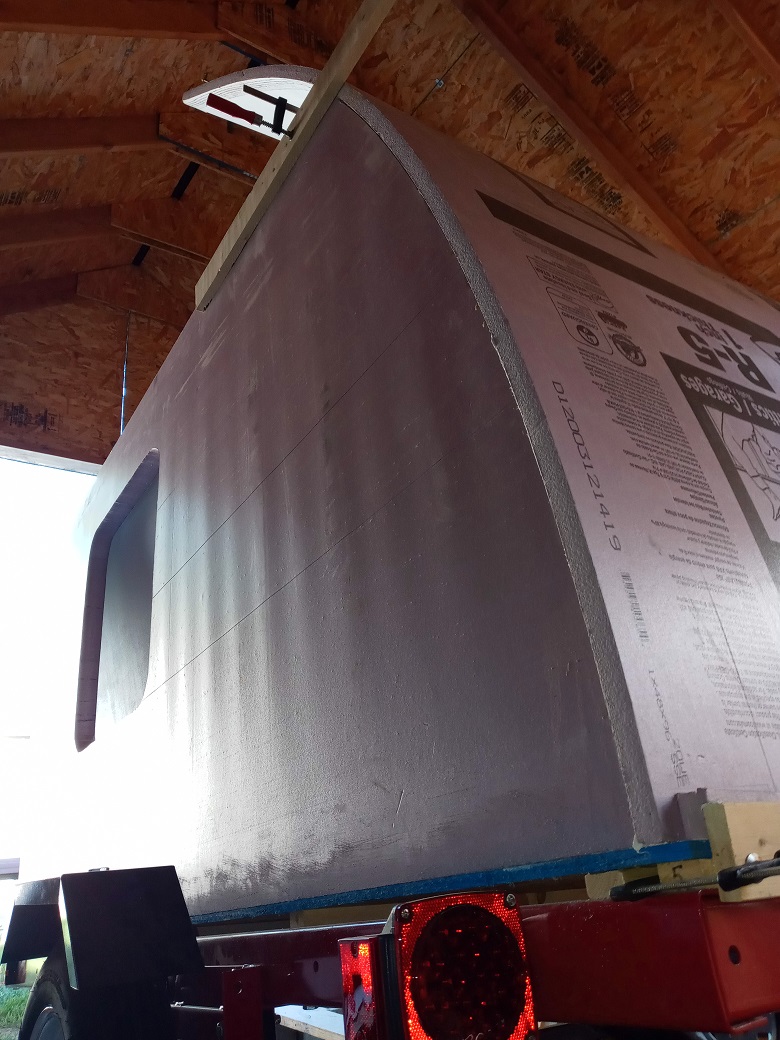

Next was gluing on the rear wall exterior skin.
rear outside wall skin
20200919_120118 s.jpg (282.61 KiB) Viewed 2202 times

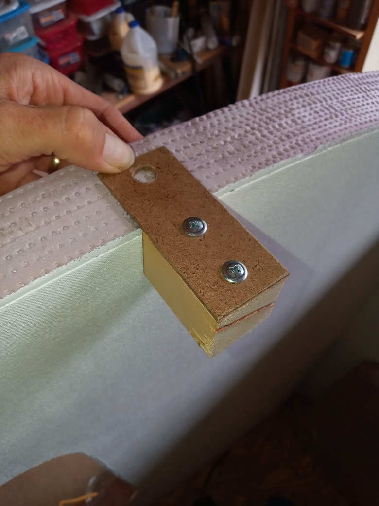

I am putting roof supports in this trailer as a test.
I made myself a jig for marking out the profile of the roof support.
rafter jig
20200925_162313 s.jpg (181.16 KiB) Viewed 2214 times
Then I drew a line around the profile jig to mark my cuts.
profile marked
20200925_162336 s.jpg (185.67 KiB) Viewed 2214 times

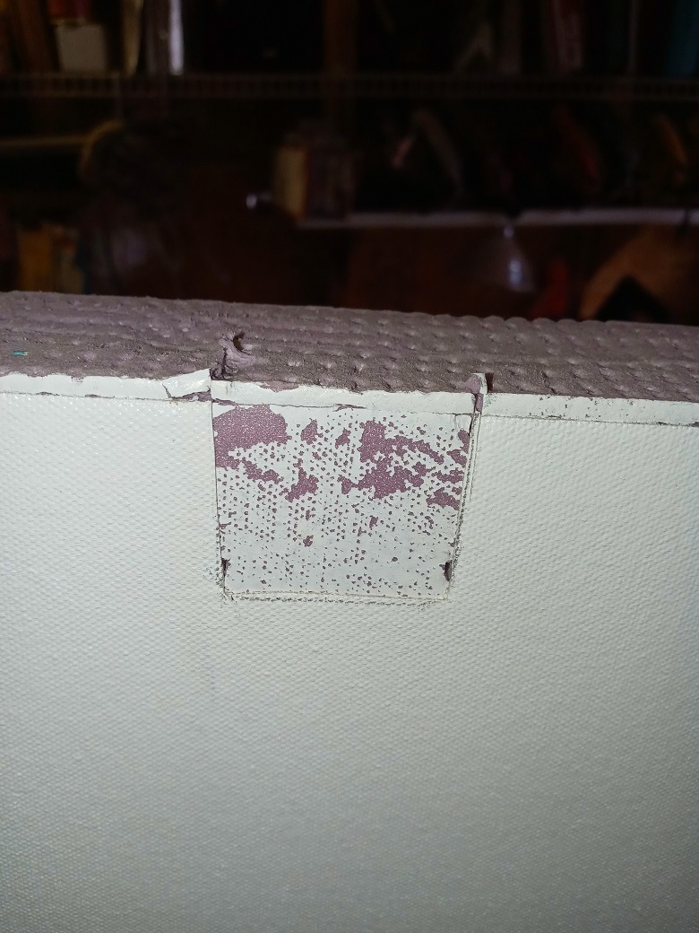

I cut the canvas and removed the cutout.
canvas removed
20200925_162538 s.jpg (237.96 KiB) Viewed 2214 times
George.

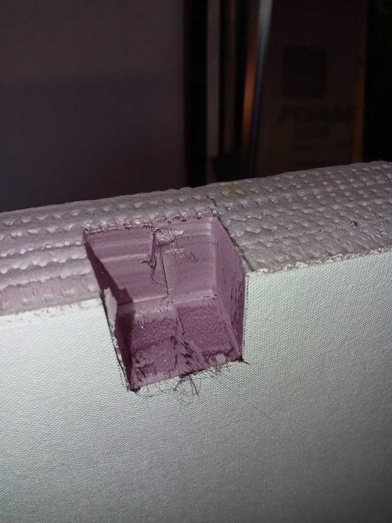

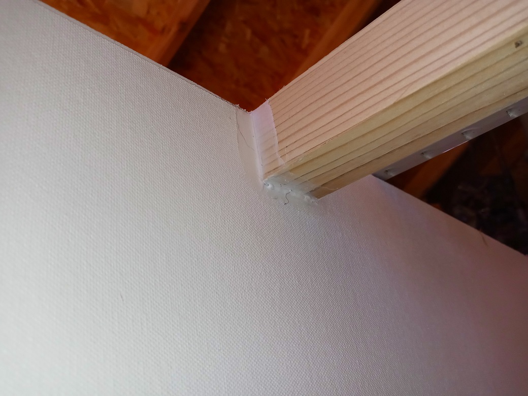

After the canvas is removed I used a hot wire to cut into the wall about 3/4 the width. This should give the rafter plenty of load support.
hot wire
20200925_164611 s.jpg (282.53 KiB) Viewed 2213 times
Then I lathered on some Dap Latex Caulk to the exposed foam.
dap
20200927_153227 s.jpg (223.4 KiB) Viewed 2213 times
And installed the rafters.
rafters
20200927_154252 s.jpg (205.34 KiB) Viewed 2213 times

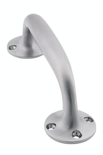

My thought was to provide some overhead hand holds to help me get in and out of the trailer. At my age it is getting harder to maneuver through those awkward spaces. I do not think foam is strong enough to support a hand hold. Wood might be the answer.
Example sold at Menards.
I searched around this site for some examples of hand holds. There is not much. I would appreciate any ideas on this subject to mull over during the winter. Maybe a simple nylon strap might be sufficient. In any case, I would think it ought to be attached to something solid like a roof beam.
Thanks,

Tom- maybe look at a medical supply shop for some handicap shower grab bars. There are more and more designs these days than the typical 2" steel bars that need three 3" wood screws at each end that need to be sunk deep into solid wood. Image

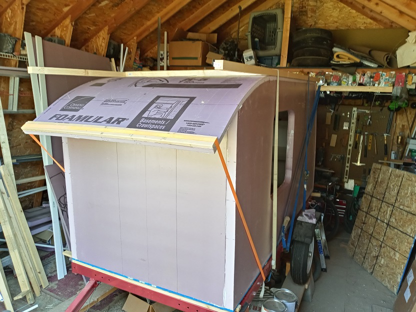

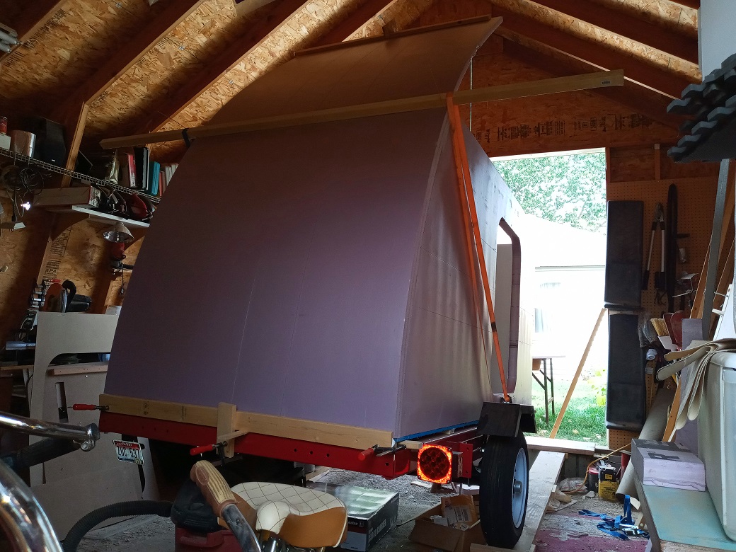

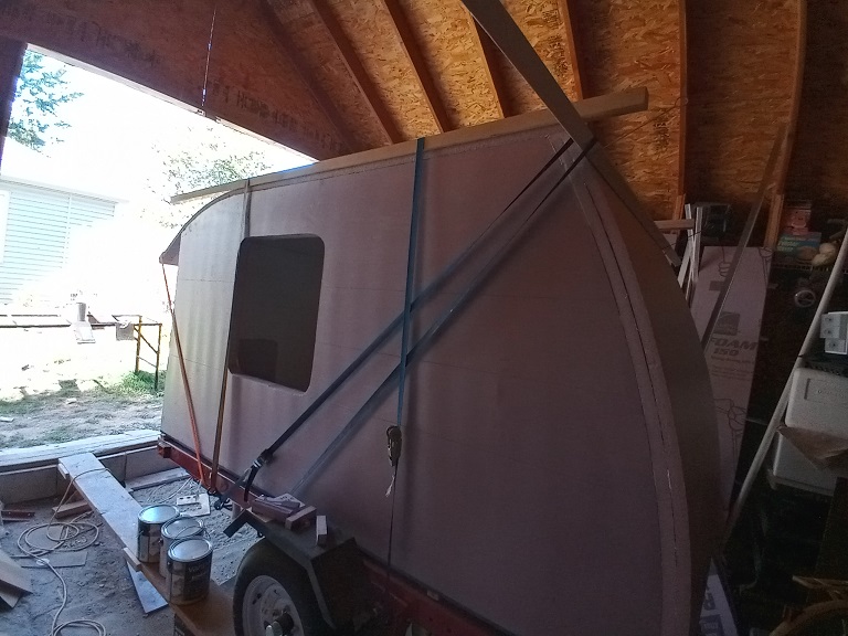

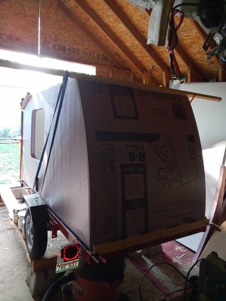

I glued on the inner roof piece. This is a 1" thick piece of foam that I was able to bend around the slight front radius. The idea is to add two pieces without having to kerf the foam. It is a bit tricky to glue this up even with this slight bend. There is still a lot of tension stored in the foam and it can overcome the glue adhesion if not prepped and glued properly.
inner roof
20201005_132331_HDR s.jpg (198.77 KiB) Viewed 2000 times
I wanted this to work better than it did so future builds could go faster. Waiting a week for the glue to dry enough so I did not have a glue failure was way more time consuming than running the kerfing tool for 1 hour. Also there is a lot of strain in the bend which deforms the curve a bit in the center. Luckily the cross members I installed helped with this a lot. My thinking is kerf for future builds.
Inner roof #2
20201005_132407_HDR s.jpg (142.95 KiB) Viewed 2000 times

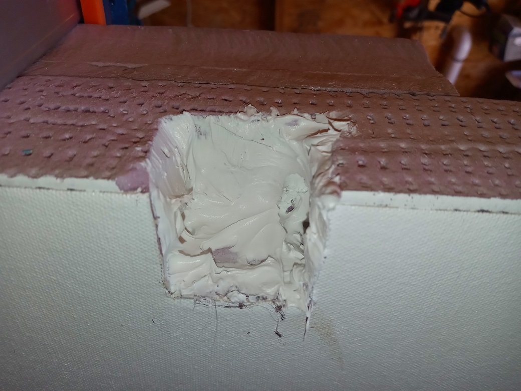

Once I got the inner roof on I found that by applying two 1" pieces of foam on the roof allowed a simple and easy way to install electrical systems in the roof. I think this is probably the way to build all foamies that will have complex electrical systems installed if thought out well.
All my builds have included electrical systems. In my first build I cut channels with a hot wire. It worked out pretty good but was very time comsuming. On my #2 and #3 builds I used a more simplified wiring system to cut time. I simply just used a drill with a extra long drill bit to drill out wiring channels. Of course this limits you to certain electrical box locations that have to be in reach of the drill bit. This pretty much also eliminated any roof electrical installs unless you got real tricky with how you drilled.

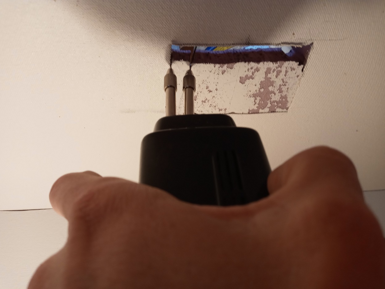

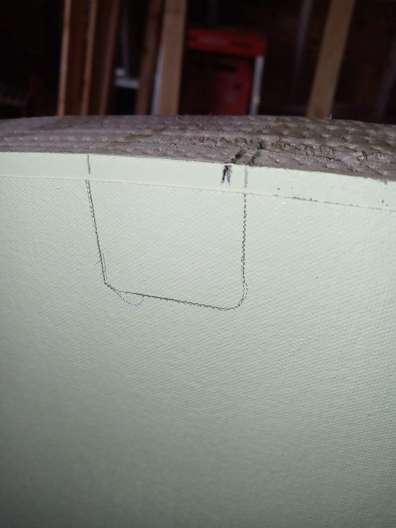

So I figure out where I want my electrical boxes and removed the canvas from that location. I then used my hot wire to cut out the foam to accept the electrical box.
electrical box
20201009_132726 s.jpg (204.97 KiB) Viewed 2000 times

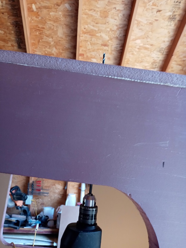

I have been using a long 3/16" drill bit that I had for a project a long time ago. With this build I found that 3/16" was too small for the wire I was going to use so I found some long wood drill bits at Harbor Freight. You can get a 3 pack of different sizes for under $10.00 which is great since just one of the bits I was using was the same price. A added bonus is that they are also 25" long. This allows for some long distant drilling to electrical boxes in isolated locations. Now this is a warning... you have to be carful when drilling through foam. The drill bit will wander and if you are not careful it could make a bad day.
So on my builds I usually have a switch box next to the door about half way up the wall and then a electrical access box above the door for the porch light. This was pretty much the extent of my electrical system for my simple builds. It was easy to drill through the door opening down through the floor, into the switch box in the wall and to the porch light access box. With using two 1" pieces for the roof I can now simply drill through the porch light box and through the inner roof piece.

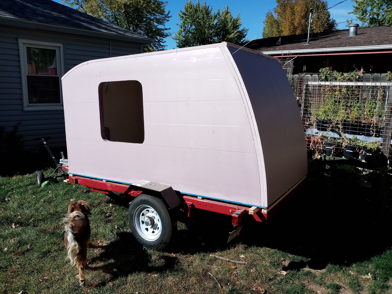

Here is the profile of the new Bug Out. I call it the "Bug Out Curvy" and I believe I have never seen a teardrop/square drop designed quite like this before. Maybe I am bias, but I think it has a good look to it. This picture was taken just before I applied the outer roof piece.
bug out profile
20201016_150140_HDR s.jpg (509.72 KiB) Viewed 1995 times
Well winter is closing in pretty fast here. I was hoping to get this one done before it got too cold. Going to be hit and miss at this point. If the weather holds another few weeks then maybe....
