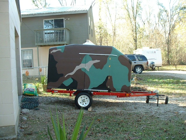

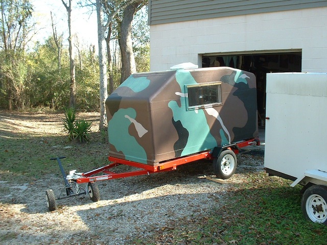

Postby rjgimp » Mon Dec 07, 2020 12:54 pm
Dot if you look through GPW's album you'll see a squarish trailer with a slanted nose and a 'camo' paint job. This all happened before I got here and I hope he'll correct me but I believe that was the first foamie GPW built (about ten years ago!) and he had it for several years. After he build the much larger, rounded "Foamstream" he sold the first trailer to another member Bonnie from Illinois and if I understand correctly she lopped off the roof and added some height to the walls then painted it an entirely different color. I was trying to find some photos or the thread where I read about Bonnie driving away with it.

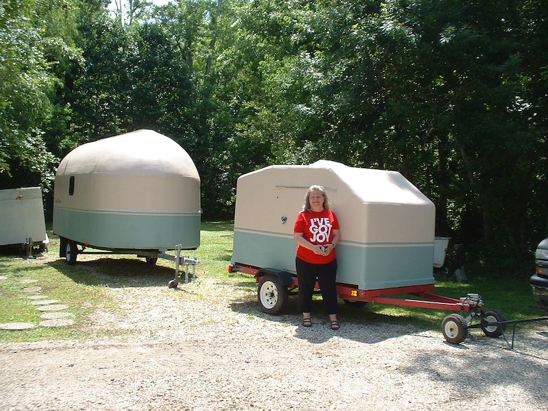

Postby GPW » Tue Dec 08, 2020 5:33 am
Well , it’s not driving away , but a pic of Bonnie with both trailers … :)
Last heard , the Foamie #1 is now the “Nookery” … and more is being added to it … :thumbsup:
Bonnie .JPG (249.96 KiB) Viewed 1647 times
