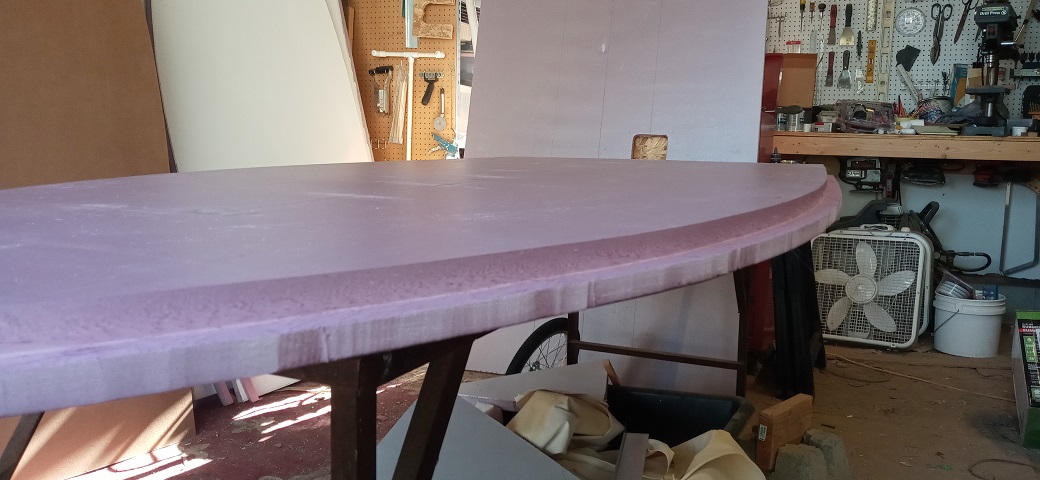

With some discussions here and other forums I decided to try a different approach for the floor. I am going to try to make a floor with 2" foam sandwiched of course with canvas on both sides. There will be a spine down the middle that will connect the hitch to the axle so I think it should be plenty strong enough.
Here is the floor getting cut out.

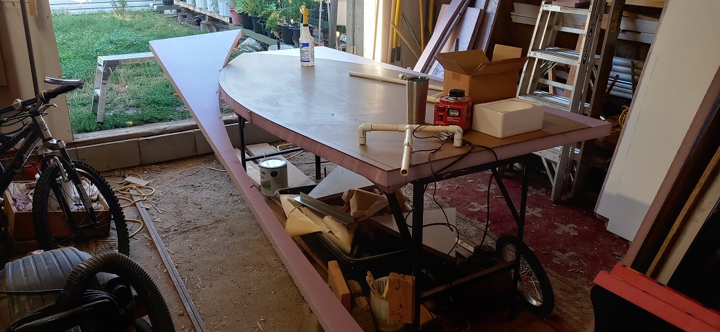

I cut dado's along the sides. This is where the walls will bed into the floor since I am doing away with the inner frame rails. Inner frame rails would be hard to install in foam anyway.

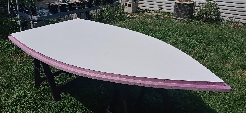

I am painting both sides of the floor with bonding primer before applying the canvas.

so I weighed the foam floor and it weighs 4lbs at this point. That is 29lbs. lighter than the OSB floor I made already. I hope this works well because that might get me in under 50lbs. for the complete build.
Well I am waiting for canvas to dry as I type. Hope to get the other side of the floor done tomorrow morning so I can start piecing this thing together.

I just weighed the floor with both sides canvas and it was 8.5lbs. I tested the strength by placing some supports under the wall areas and it held my weight no problem. There will be a small frame that will run down the middle to attach the hitch and axle together. This will also help with supporting weight in the center.
I will be adding 1/2" high density foam to the floor. I think at this time that it should protect the floor enough to keep it from denting with pressure points. I like the 1/2" foam because it holds cargo in place well and is comfortable to move around on.
I weighed everything individually and at this point it looks to be about 45lbs. That gives me 5lbs for exterior glue and paint. If I calculated it correctly it should be right at 50lbs. If not is should be well under 60lbs. Not bad since I was starting at 100lbs.
