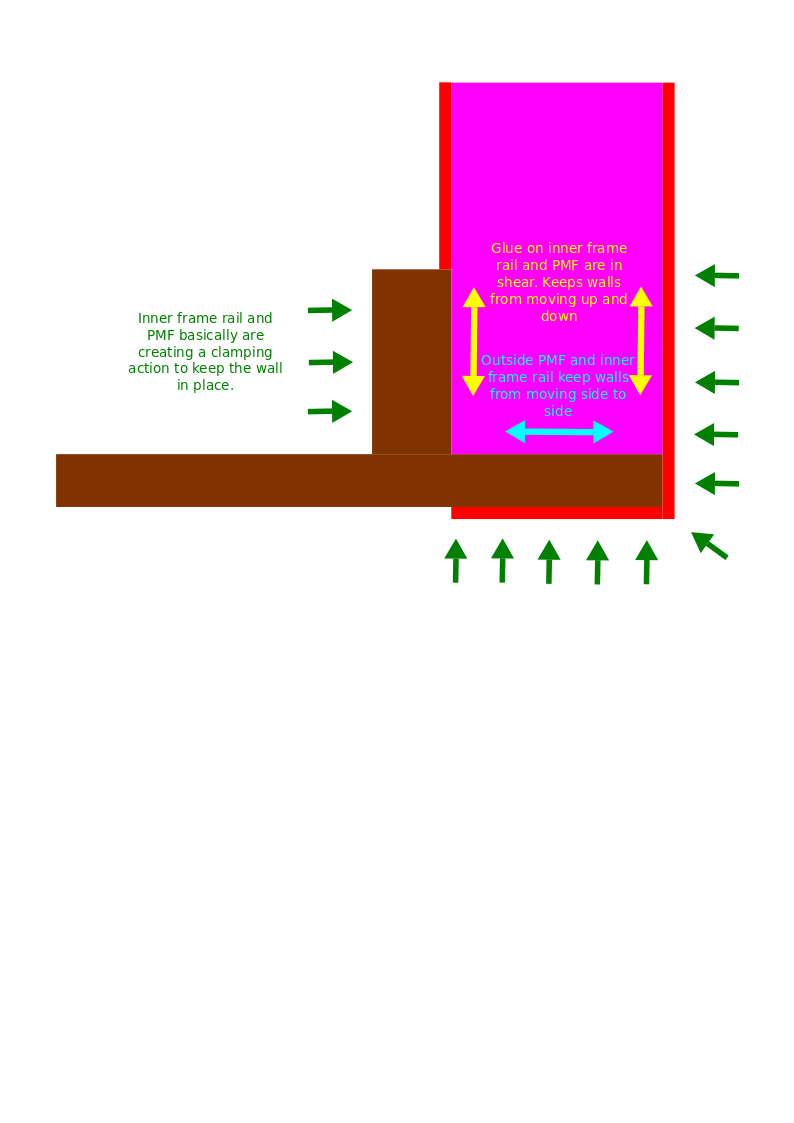

Postby ghcoe » Sat Jul 17, 2021 3:43 pm
printer wrote:That is the second time the link to the photo file went dead, no idea why.
Yes, untreated canvas. I am debating washing it first to remove any manufacturing product. I doubt there is any but hate to find out later.
No need to over complicate this. Get rid of the wood on the edge of the floor. That is going to cause a issue once the foam and wood start to expand and contract at different values...
This is how it should be done.
Explained
Inner Frame Rail and PMF explanined.png (36.23 KiB) Viewed 821 times
If you want insulation on the floor I would just cut panels that fit the areas and glue them to the floor directly. Wrap canvas around the edge along the wall before you glue it on. Apply caulk along the seam and done. Since there is no wood that low I don't even think I would apply a drip edge. :thinking:

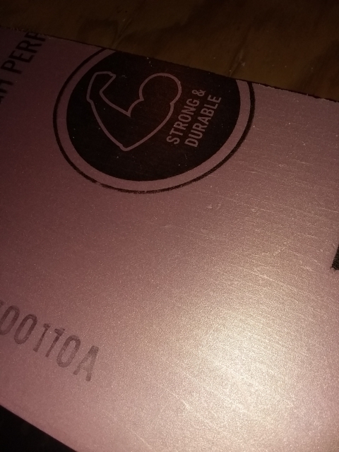

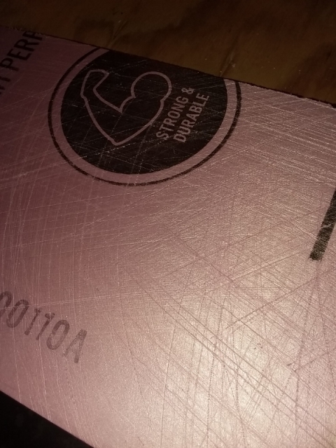

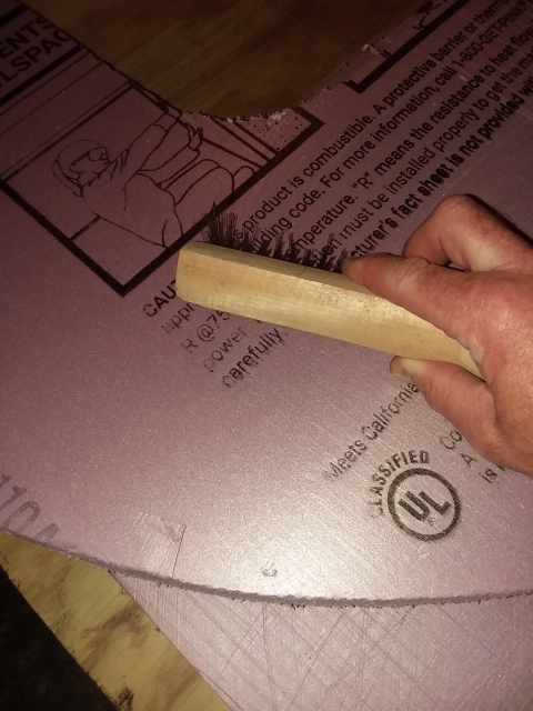

Before scoring foam
Scoring with old wire brush
Scored foam. My tests showed it really grips. No primer used, TBII 75%/water 25%
