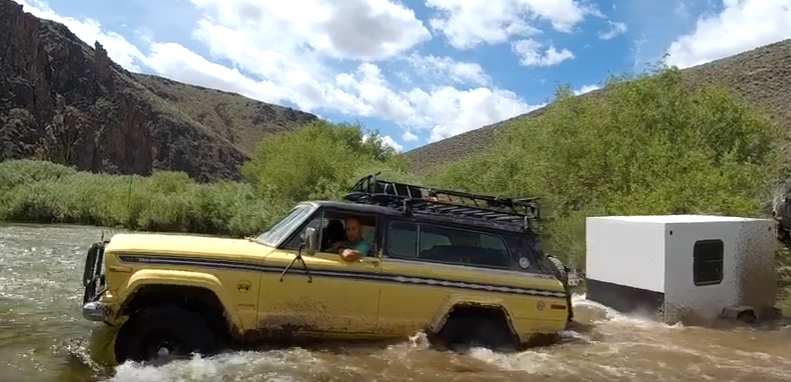

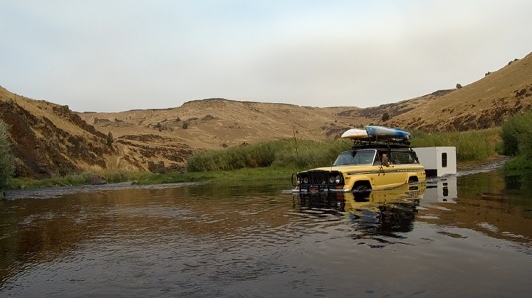

I agree a properly built wood trailer can last if properly built. How do you know it is properly built though. Most people here are not professional builders. Foam gives you that extra bit of piece of mind knowing that if there is a leak (and there is not) that it wont be a expensive repair next spring.
I use OSB for my floors, 3 years and many a water crossing and still not soggy. It can't get soggy if it don't get wet for long periods of time. Why because it is protected by foam. Just my two cents... :thumbsup:
Video of river crossing:
https://youtu.be/q03JboEM4o0?t=518
River Crossing 1.png (728.67 KiB) Viewed 733 times
River Crossing 2 s.png (508.31 KiB) Viewed 733 times

I have non closable vents to keep me alive when I am sleeping with the door and windows shut. It is that air tight. It follows me down dusty roads and if dust don't get in water wont get in. The only way water is getting in is me breathing, or I leave a window/door open. The vents do their job just fine for airing out in storage.
I was always afraid of building a teardrop and having it rot. I have known of, and heard of many that have deteriorated over a winters nap because they leaked. Only takes once. Then I heard of foamies and my worries were over... :thumbsup:
Since my first build I don't even consider installing a roof vent. Just a bad idea if you want to keep the water out. Plus you don't get moisture drips on your bedding while you sleep and night. :thumbsup:
