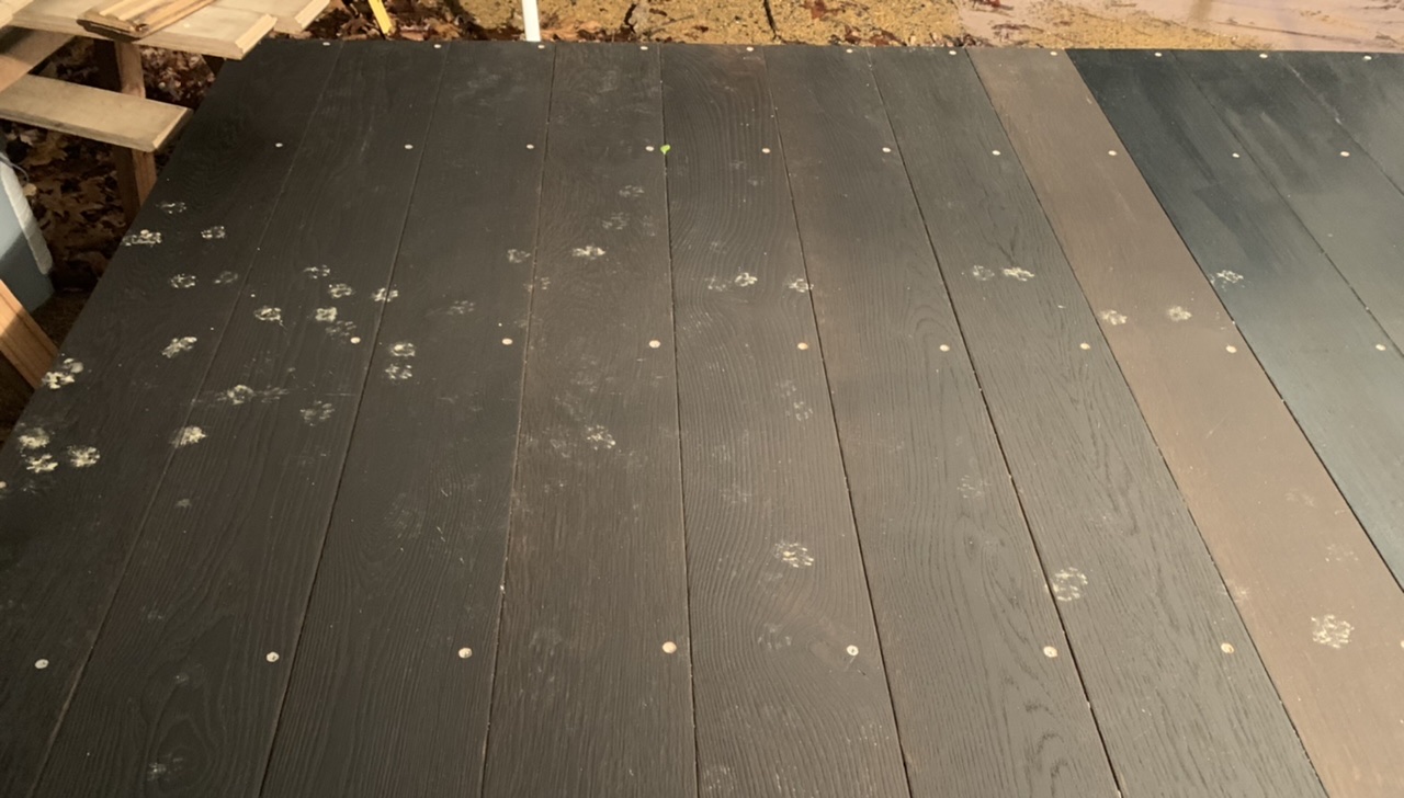

Every time I get the blackened oak flooring of the trailer cleaned up, my kitty has to “help”; she walks over it with muddy paws!

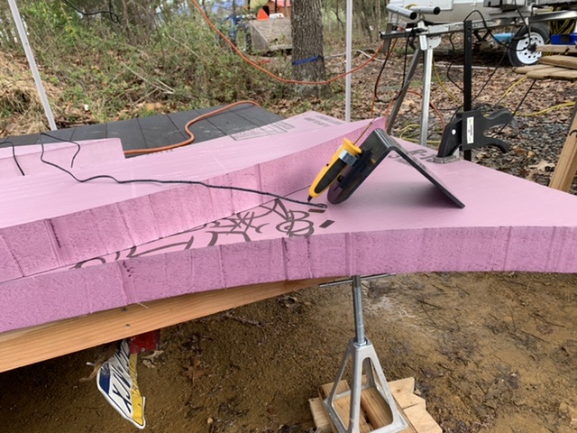

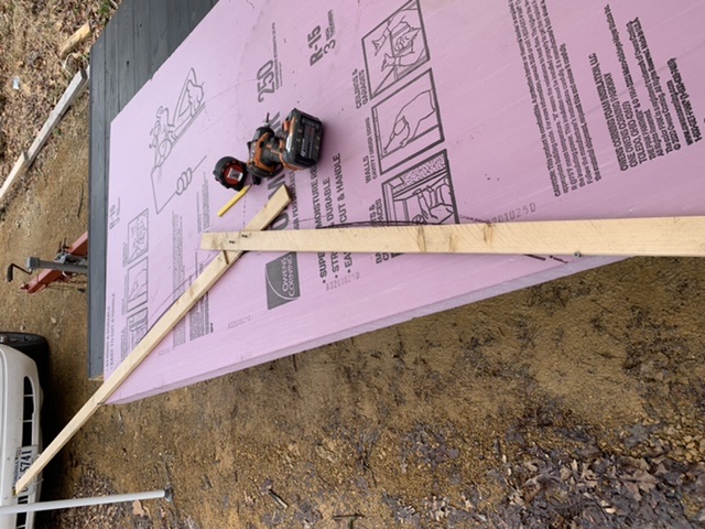

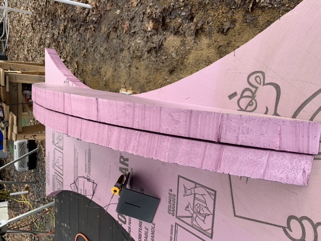

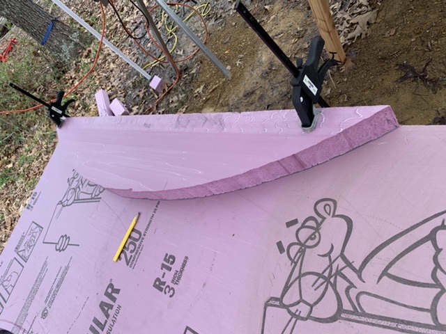

I finally got to the point of working with the 3” xps. Since I’m building a vardo style Foamie, I need arches for each end. I followed the instructions for drawing a large arc here:
https://m.youtube.com/watch?v=ykzQurvEqOo
I’m using the Hot Wire Foam Factory 4” hot knife with their Crafters Power supply and their Adjustable Sled Guide to hold the hot knife. This was my first try with the hot knife and using the sled guide to steady it.
The first arch turned out ok but far from perfect. My biggest mistake was in trying to hurry up the cutting with the 4” hot knife. Frankly because I’m cutting 3” xps instead of 2” I think I was trying to hurry it and bent the metal wand of the hot knife. It’s easily straitened but this Crafters level hot knife and power supply is way too slow for 3”xps.
First arch:
BrianInVA
Posts: 92
Joined: Wed Jan 26, 2022 8:49 pm
Re: Flyin’ Gypsy - 6x10 vardo style Foamie build
Postby BrianInVA » Sat Apr 09, 2022 4:24 pm

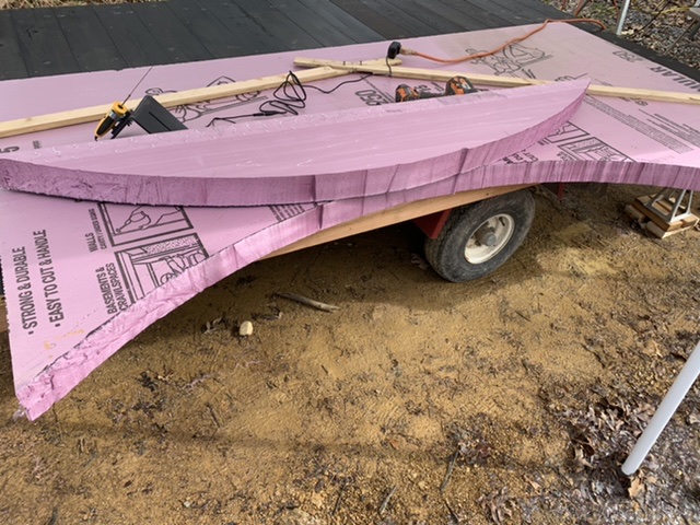

Tracing out the second arch:
Second arch:
The two arches compared. They’re actually fairly decent and definitely usuable considering this was my first try with a hot knife:

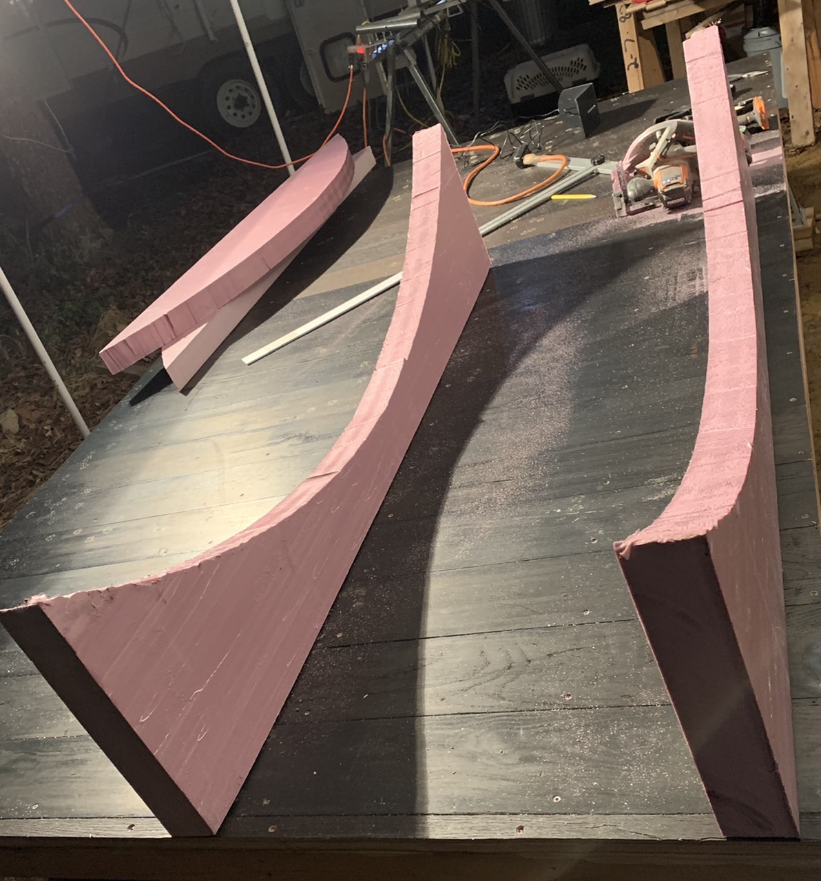

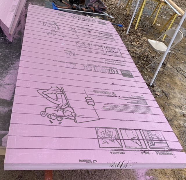

The templates for the curved roof xps sheets, from cutting out the arches for each end. I’m making the arch 12” tall; I’ll cut kerfs every three inches in the xps sheets with a circular saw for the bend.
BrianInVA

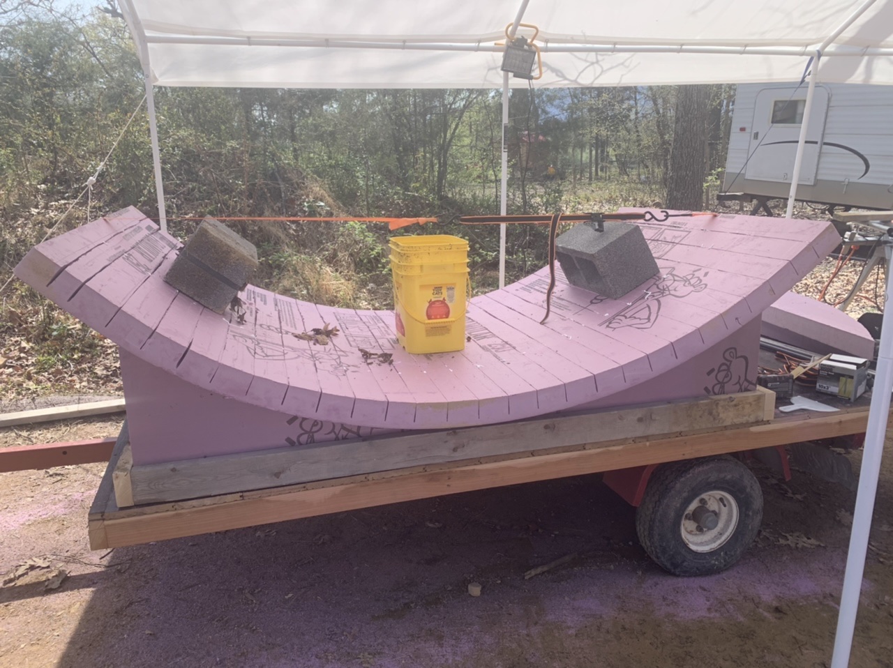

Cutting kerfs in the xps every 3.5” with a circular saw. Unfortunately the xps gums up the circular saw blade and makes the kerfs wider in spots.

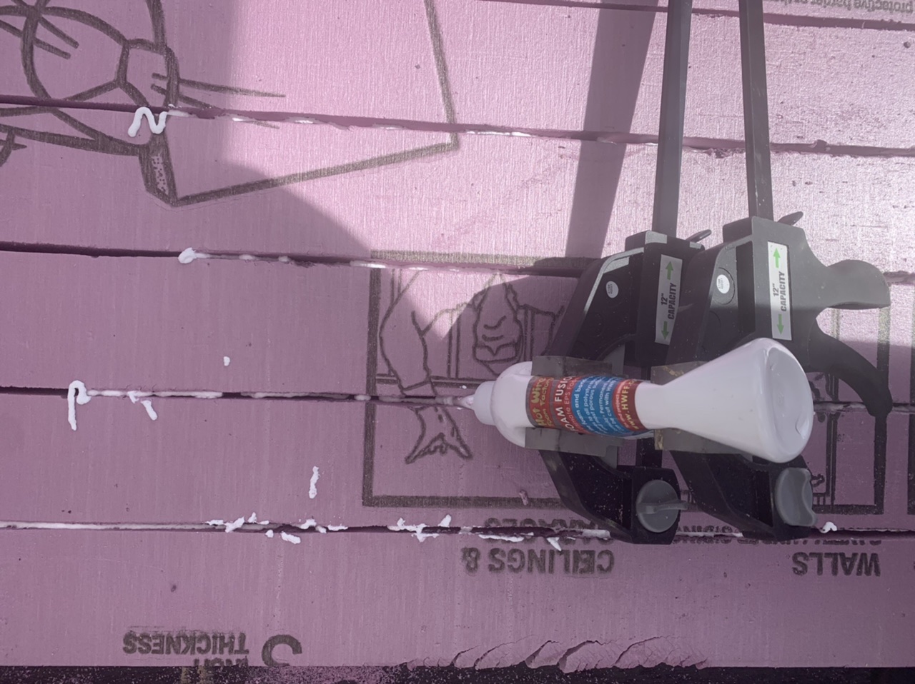

Postby BrianInVA » Mon Apr 11, 2022 10:39 am
The Foam Fusion glue I’m using to close the kerfs was really thick. I could hardly get it out of the bottle, but I suspect since it got down to 30• last night it was half frozen LOL
Regardless, it fit into the arch forms quite well.
Once I apply the pmf to the inside of the roof panel it should be quite rigid.

BrianInVA wrote:The Foam Fusion glue I’m using to close the kerfs was really thick. I could hardly get it out of the bottle, but I suspect since it got down to 30• last night it was half frozen LOL
DEFINITELY my mistake here.
I took the Foam Fusion bottle inside and put it in a pan of hot tap water and by the time the tap water had cooled to room temperature, the Foam Fusion had returned to the look and consistency of Elmers Glue. It was very easy to apply in that (proper!) consistency, and I went back and “injected” it with their 8oz squeeze bottle into all the kerfs that looked like they needed more.

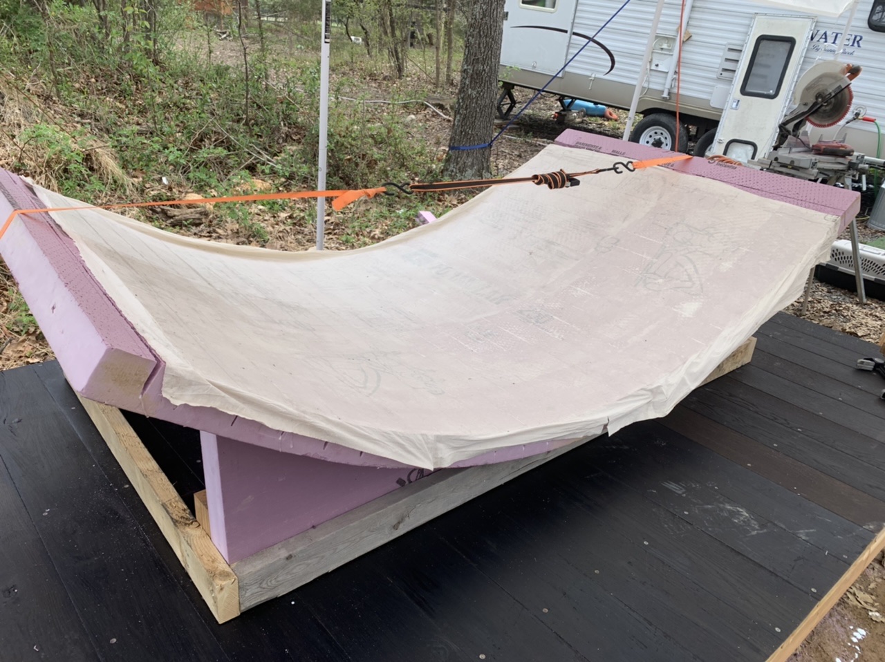

Postby BrianInVA » Wed Apr 13, 2022 1:12 pm

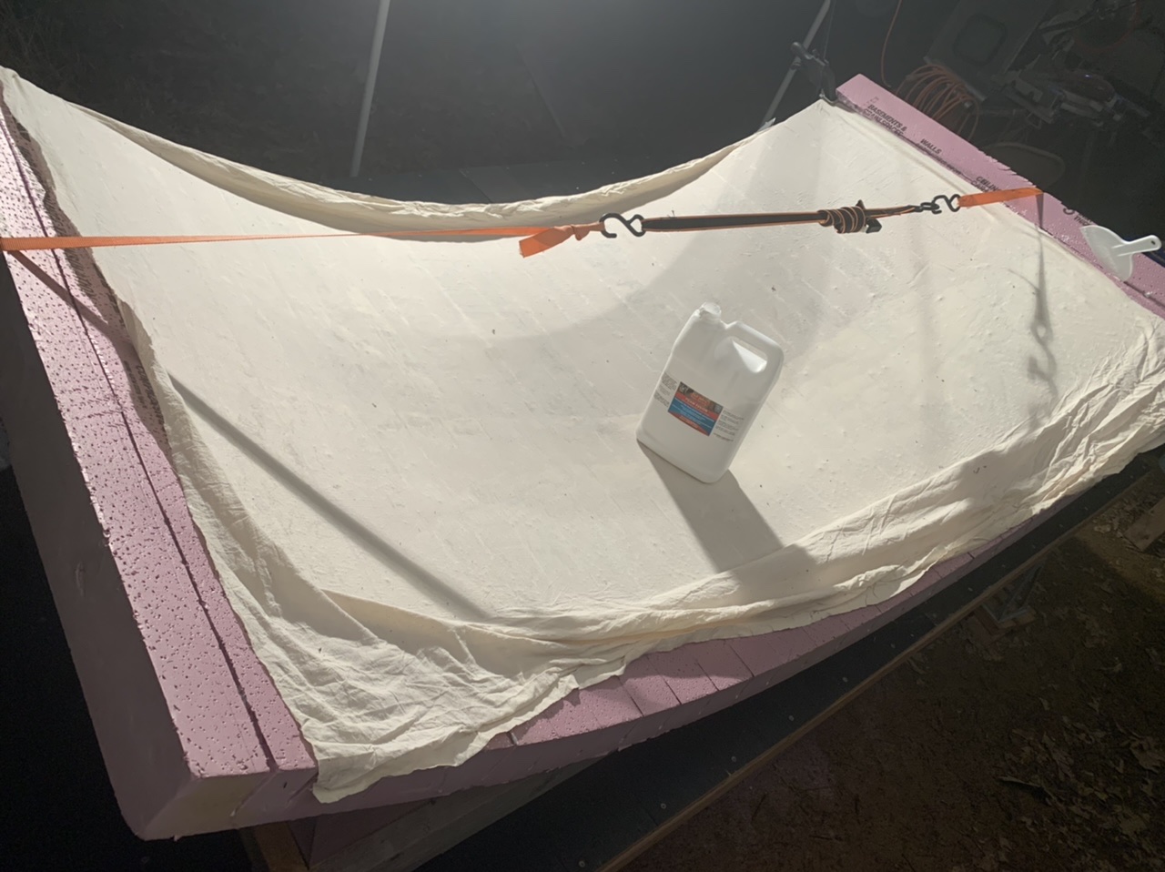

Last night I applied the first layer of the pmf to the interior side of the first arched panel. I used muslin bought in a ten yard package from Amazon and the Foam Fusion glue. At room temp the Foam Fusion pours on and spreads easily. I prepared the xps surface with a wallpaper perforator from Amazon and used a wide spatula from Harbor Freight to spread the Foam Fusion. The muslin was starched out and pressed onto to glue by hand. The Foam Fusion held it firmly. After I had the whole panel covered I applied a second thin coat of the Foam Fusion over the muslin. Overall I’m pleased with how it turned out for a first effort at this process.
This photo is just before I finished glueing the muslin to the arched roof panel.
I put the thin coating of Foam Fusion on top the muslin last night. This is what it looks like today. The adherence is quite strong but I’ve never tried Titebond II to compare it.
I have lots of pieces of xps and some Titebond II so I’ll do some tests comparing the adhesion of both that and the Foam Fusion to the muslin.
