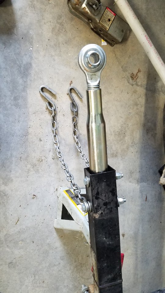

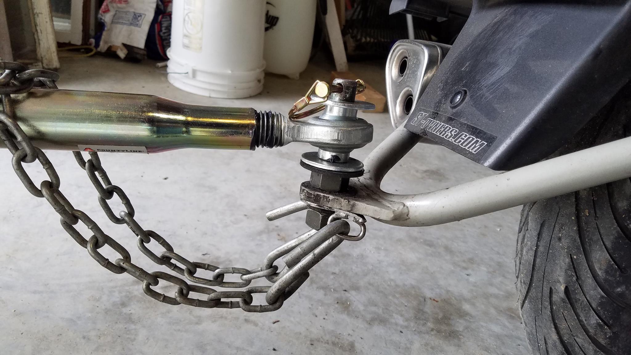

Postby BrianInVA » Fri May 06, 2022 7:21 pm
A motorcycle trailer has two wheels flat on the pavement, but the motorcycle needs to be able to lean in corners, so they put swivel hitches on motorcycle trailers. The gold standard for swivel hitches is the Helms hitch, which looks like this:
Unfortunately new swivel hitches cost $150-$250, and I only paid a little more than that for this trailer. After extensive searching I found a website outlining a diy swivel hitch explanation. It looks to be a quite satisfactory version of a Helm swivel hitch:
The parts are a Category 1 tractor top link and a long large 3/4” bolt. I found them for $30 at Rural King yesterday. Today I picked up some 2”x2” 11g steel box tubing to replace the current tongue with a longer one and have a 4’ cross piece at the front to mount the foamie camper floor on left over.
BrianInVA
