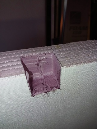

I do think though, you will find the rafter ends telegraphing through your fiberglass layup. Foam and wood expand at different rates and under certain thermal conditions you will find the wood trying to poke out of the foam. This will lead to delamination of the fiberglass and foam at those locations.
On my build that I used raters I imbedded them into the foam walls but did not cut the slots all the way to the outside of the wall. You could do the same thing with your roof. If there is only a thin layer of foam over the wood, I would create a small air gap to allow the wood to move without pushing on the foam. Thicker foam would probably be ok since the foam could absorb some of the movement.
Hey, Thanks George! The different expansion rates never crossed my mind. Another thing to chew on...
