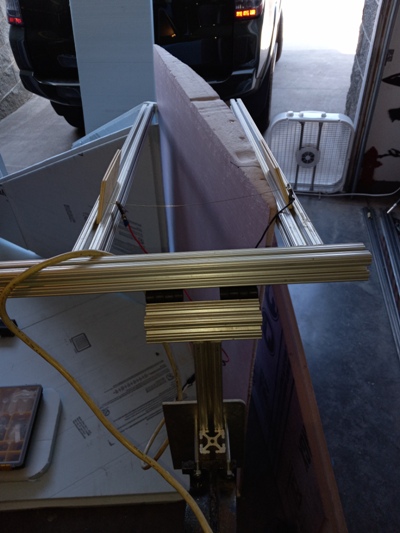

Postby twisted lines » Wed Sep 20, 2023 10:42 am
Setting up and cutting that line .
This side my anderson plugs unplugged while cutting. (Good side) :thumbdown:
Looking at the good side.
Good side.jpg (56.31 KiB) Viewed 2631 times
Second side slid on the floor while pulling the wire :thumbdown:
Now I can forget it, and adjust as needed :thumbsup:

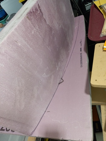

Postby twisted lines » Wed Sep 27, 2023 12:16 pm
Now I have traced the line from the side to the flat side on the top;
Try to figure it out? (Radius)
Or try & make a hot wire to cut it :roll:
That line.jpg (69.67 KiB) Viewed 2535 times

Postby Pmullen503 » Wed Sep 27, 2023 2:56 pm
I've found a flush cut saw useful for trimming foam flush with another surface. I always but a piece of cardboard on top of the piece I'm cutting flush to to protect it from the blade. Plus, it leaves a lip on the trimmed piece so I can sand it truly flush to the other piece.
Easier, and less risky than trying to hot wire it.

Re: One more line
Postby twisted lines » Sat Sep 30, 2023 10:33 am
Pmullen503 wrote:I've found a flush cut saw useful for trimming foam flush with another surface. I always but a piece of cardboard on top of the piece I'm cutting flush to to protect it from the blade. Plus, it leaves a lip on the trimmed piece so I can sand it truly flush to the other piece.
Thanks for sharing!
May be the only tool; I know where it is.
I Now have tried it :thumbsup: & Like it.

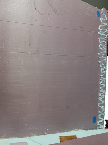

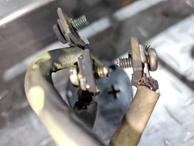

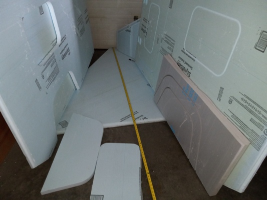

Postby twisted lines » Mon Mar 11, 2024 2:22 pm
Trailer is smaller (Broke it) :frightened:
I guess the pile is getting Bigger.
And my new to me, welder works on 110.
220 Cord went POW guess I may open that up today!
Just The Plaz plug :thumbsup:
Two screws touched unpluging fixed that, Glad I wear gloves :o
Racking up; And Rapin foam

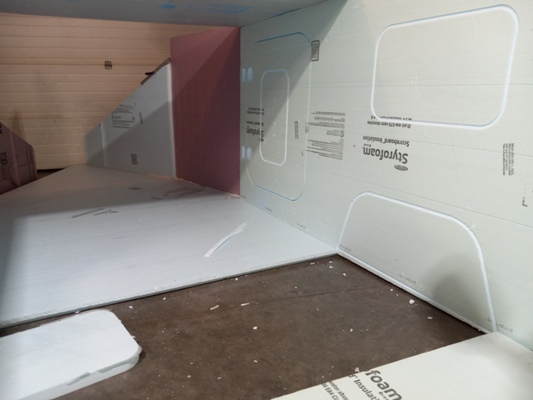

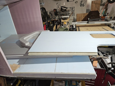

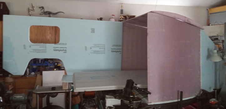

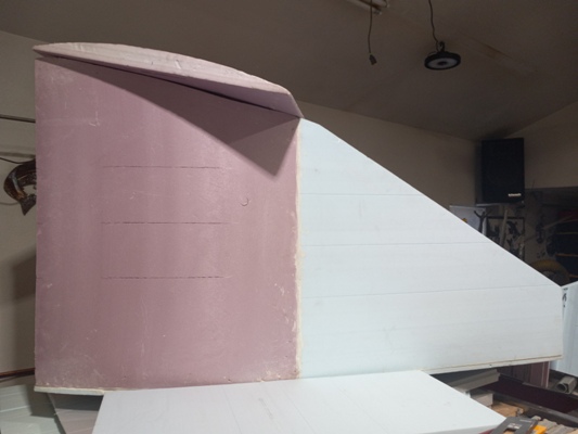

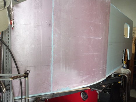

Postby twisted lines » Thu May 16, 2024 7:32 pm

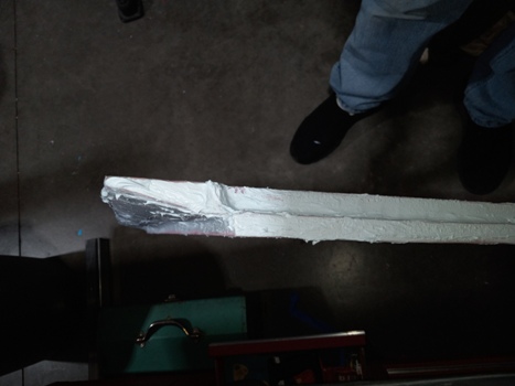

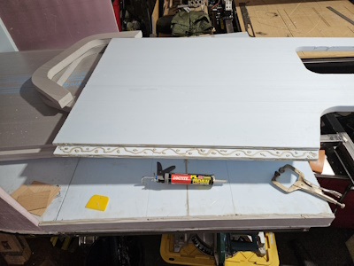

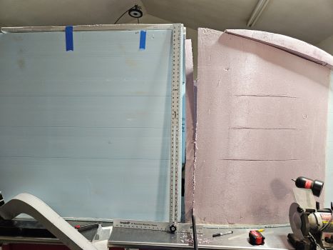

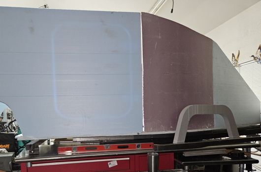

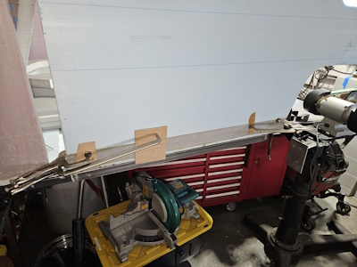

Broke the floor where the PL premium tube is, & tore this wall off when I fell,
I took them with me; Made for a soft landing ;)
Cut the other wall off to fix the floor, should be fine Almost glued it on today.
Did this yesterday afternoon, checked it for level adjusted, then started trimming
after the picture I could not cut anymore with the exato, used a very sharp chisel
It's Very hard & fast. Last picture next post, limit 3
