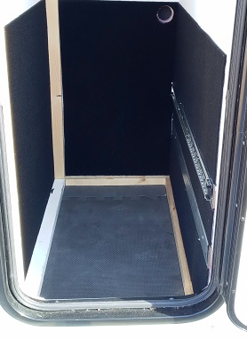

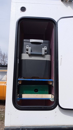

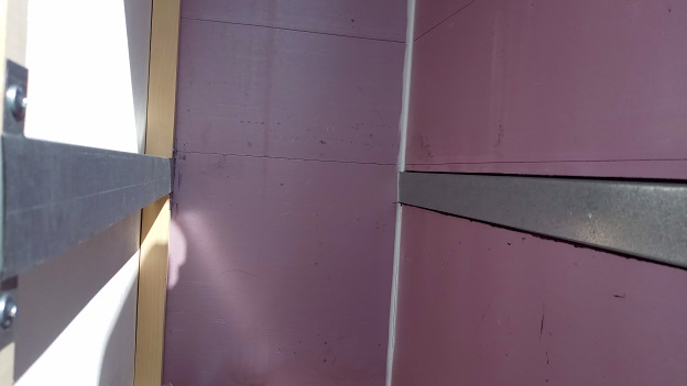

This is how I make hard points for drawer sliders.
Slider hard point
20220318_124332 s.jpg (294.34 KiB) Viewed 1726 times
Slider hard point with slider
20220328_103142 s.jpg (294.86 KiB) Viewed 1726 times
It supports a 52qt refrigerator fully loaded on rough roads without any issues. Been two years since the install now.
