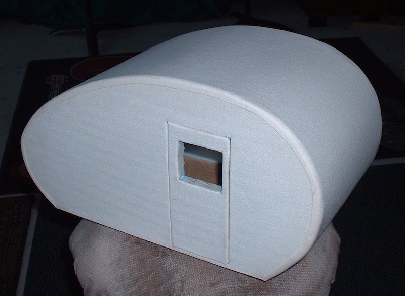

Eagle , all done now ... covering was pretty EASY ... thinking on a large build , a couple extra hands wouldn't hurt , Clean hands that is ... The material on the roof overlapping the sides , went on well without any puckering on the curves.. :o I'd think a 2" or 3" overlap would be No problem on a large build , more around the floor , it's straight and very easy... It's drying now as the camera batteries charge ... I just laid down the glue , stretched the canvas over the foam and smoothed it out ... wasn't planning on a top coat of glue ... not really necessary as the paint will cover all ... and soak in the canvas better ... You could do anything you want with it finish wise , clear , paint , artwork , whatever.. a primer over the canvas would give a smoother surface ... I'm not worried about that ...
I'd just think of, and treat this as one would with a fiberglass trailer ... same thing basically ... and no reason why fiberglass could be used on this ... So a hatch could be lightly framed and covered ... not much stress on a light hatch ... Board inset for the hinges on each side ... For me , The Sleeper would be stronger as one piece , without the galley hatch ... besides at my age , I'm more of a "grazer" than a cooker .. Natural diet , fruit , berries , nuts, vegs ... All I have to do is make coffee... 8) And I can cook legumes in my solar cooker if I want to splurge ... and it's sunny ... :roll: My latest solar cooker is a windshield reflector/protector and a large glass jar ... Elementary ... easily stowed... I can easily make tea or coffee solar too , just impatient for coffee in the morning ... :oops:
Postby GPW » Tue Nov 23, 2010 5:12 pm
OK, Covered and dry .... Pics in my album ...
Notice the one side with the messy fingerprints /smudges ... grrrrr!!! Got it right on the other side and the top ...
Also notice how smoothly the overlapping seams were , no puckering around the profile ... although you can see loose threads from the fabric edges ... an occurrence possible with a bigger one too...maybe pinking shears would prevent this ....
I learned a lot from the model ... :thumbsup: Image

:applause: that is really cute.

Eagle , Thanks !!! I figured since I have my acrylic paints out , might as well go all the way and put a fancy paint job on it ... Got some clear plastic for the windows , balsa wood for window frames.... now all I have to find is a teeny tiny trailer ... :roll:
For now I'm going to forgo the reinforcement strips , but you can imagine where they'll go , overlapping every seam ... on the Big one ...
The canvas cloth , even a bit heavy weight for the model worked beautifully ... molding around the edges and such with ease ... I assumed I'd have to make V cuts on the curves, but didn't have to...Nice !!! :thumbsup:
Bottom line , I was surprised how EASY this was to make ... no mess , no fumes , save the bits of blue foam sawdust ... Water clean up ... You could literally do this in the living room .... as long as you sanded the foam outside ... :roll:

I don't think I really want to take it that far ... :roll: Just a proof of concept model ... Very happy with the results already .... It's amazingly strong now , just with the outer covering ... proof enough for me to be confident in a Big one ... ;)
Current thinking is, with the wood in the stressed places, wrapped and painted , normal water intrusion would be blocked , and even if it leaked :o the wood would be still protected... Nothing else to rot... and it would still be Really Light .... oughta' tow like a feather... Can't really think of any way lighter ...yet strong enough to be durable ... :thinking:
