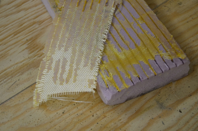

Postby OP827 » Tue May 05, 2015 9:21 pm
OK, the destructive test of TB2+Fiberglass cloth on foam results are in. Here is the picture:
Observations: with the grooves, the bond was extremely strong, I thought I need plyers to pull the skin apart. The Cloth was tearing off to pieces too when it came off.
My conclusions: the way it separated in many places it clearly showed that the FG cloth is not getting impregrated as it would with Epoxy resin composite. Glass fibers do not get "wet" completely by TB2 thus NOT becoming an integral part of the laminate.
Therefore if FB cloth is being used I would rather stick to the traditional Epoxy laminate. Another question answered.

Postby GPW » Wed May 06, 2015 6:00 am
Thinned TB2 will wet the FG cloth ... ;) JMHO, TB2 is too thick straight from the bottle ... we routinely thin it for different purposes ... :thumbsup:

Postby Wobbly Wheels » Wed May 06, 2015 8:49 am
The glass will indeed wet out as shown between the starved area in the pic. It's a strictly mechanical process so I suspect it just just takes a little more "settin' time" like when you're wetting out a heavy Dynel with poly resin. Like GPW suggested, thinning the resin would likely help a lot. Those dry, starved areas are where any laminate falls down.
Using a peel test isn't necessarily the best way to measure a bond because you are testing only the very edge of the laminate. A better test would try to pull the whole laminate at once, like Gougeon does with their PATTI tests. I'm sure one could rig up a way to run a similar test. As long as the foam fails before the bond does (which is what I would expect to see), the test is a pass.

Postby OP827 » Wed May 06, 2015 9:22 am
Pulling the whole skin at once is a better test I agree, but it requires special jigs etc. GPW is right the TB2 glue is much thicker out of the bottle than epoxy, epoxy is originaly designed for laminating with fiberglass cloth. My take on this is that these small glass fibers by their nature is not as good for wetting with water based glues as sticky and liquid epoxy sirup stuff. To make them wet with TB2 all through may require so much water that it will actually reduce the strength of TB2 and will require multiple coats which does not make the work more economical than original method with epoxy. My view on this that canvas fibers are naturally much more suitable for wetting with water based glue, while glass fibers are not as much. I feel that TB2 works best with canvas, it is like a natural thing to do.
I feel that fiberglass cloth wets best with epoxy, all fibers become invisible and transparent, it is ok to call me stuborn. Diluted TB2 and fiberglass(TB2+FB) will work for sure and it will be fine for a complete sock skin over a teardrop as in foamies, I just feel that I would need more rigidity, strength and sandability for my experimental foldable build than this TB2+FB material combination and technique offers. Although somewhat reluctantly, I would have to stick with epoxy for the combination with FB cloth.
I am having second thoughts now. May still do more testing in attempt to use TB2+FG inside for some partition walls and roof skin. I even think of TB2+canvas for inside :shock: - for a nice looking texture. I'll think of it when I get to that point.

Postby GPW » Wed May 06, 2015 5:00 pm
“ that it will actually reduce the strength of TB2 “ .... logical but not quite applicable , only because even thinned TB2 will make a stronger bond than the Foam ... The foam always will fail first , not the glue ... Try wetting the fiberglass cloth with plain water before applying the glue , A common spray bottle will work ...
Re: glue info for foamies
Postby Wolffarmer » Wed May 06, 2015 5:42 pm
Would a bit of surfactant in the water. and/or the TB help?
