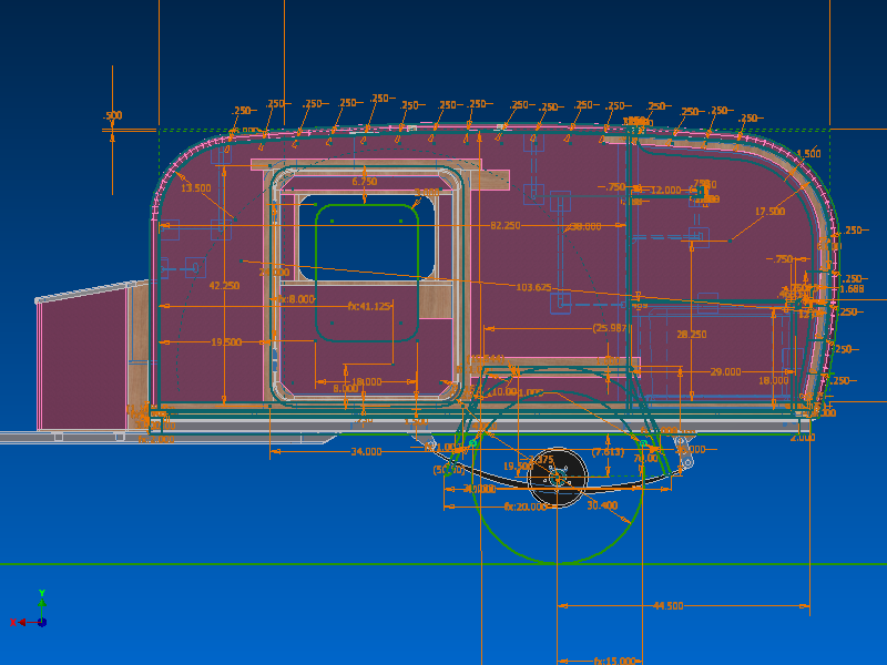

I’m here at work getting a little something done on the trailer (crickets...plant shut down for holiday). I'll post pic's and details later when I get home, but I was doing some design updating intermingled with browsing around on the forum. Threw in my $0.02 on Pahrumpcaveman’s build thread here and got to wondering why my axle was so far back. Concerned about fender clearance with the door opening, maybe? I did have my door outline just a little bigger in the sketch than I ended up with in the model, too.
Anyway, I have now moved my axle up to 44-1/2 inch from the rear of the frame. Here’s a rendering of the new location superimposed with the detailed side profile sketch.
Looks a lot more like the original hand sketch and will be much more forgiving should I decide to put one or two 12v batteries in the tongue box (I may only have one, or I can split them up and have one in the galley, or just one in the galley… so I’m pretty flexible on balance).

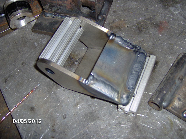

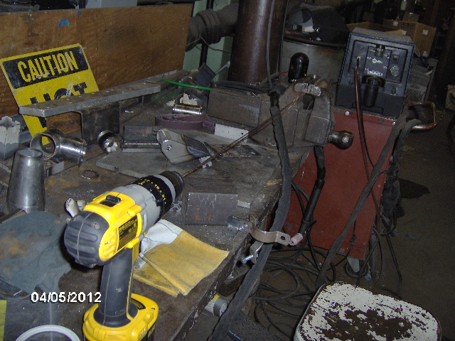

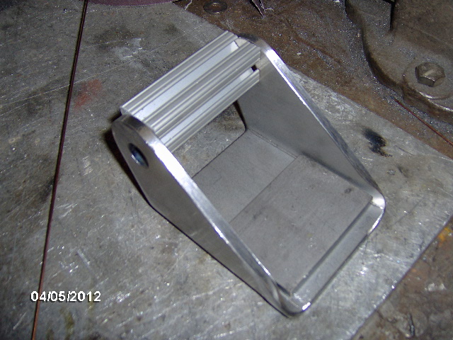

Starting out on Thursday night after work:
The Ruff Stuff hanger parts came unwelded. First I cut a scrap piece of 80/20 extruded aluminum (just because it was handy and aluminum cuts easy) to fit snug in between the spring hanger ears. This will keep the ears from sucking in while welding the little gusset (rock slider) plate in place, especially since the gussets (seen inside the hanger) were a very loose fit and a bit of filler would be required.
Here I have a couple of more pieces of 80/20 holding the gusset up, and a piece of scrap angle setting it flush.
90408
The only steel filler rod we had was 1/16 diameter. I welded the first one up shoving this wire almost as fast as I could (see hanger on heavy aluminum welding surface plate in middle). But that would not do, so I twisted 3 wires together using a cordless drill and the vise.
Here's a crappy close up of the twisted wire with the welded hanger in the back ground.
90410
And another better pic of the welded hanger with the twisted rod to the left.

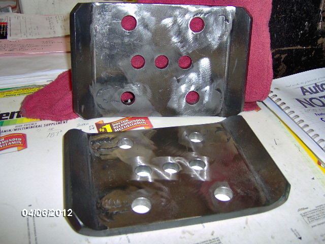

On Wednesday when I went up to Fab Mecca I wasn't able to get much done due to shop priorities, but I did manage to slice off a couple of 5/8 wide lengths from a piece of 3/8 x 6 flat bar; rounded the corners a little on the Bader and cut a bunch of 1-1/8 long slugs to fill the over size slots in the U-Bolt plates (the slots were sized for larger U-Bolt diameter and larger axle diameter).

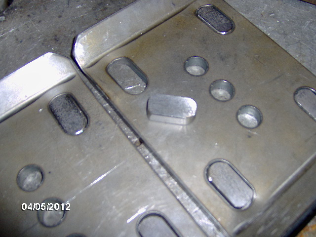

I know. I could have just made the slots a little longer with a die grinder, or in the mill, but I would never have been happy with that. ;)
Here's one with the slugs welded in from the bottom and top.
90413 90414
And here they are ground and sanded flush.
90415 90416 90417
Ignore the little bit of weld undercutting; I'll be using SAE flat washers under the U-Bolt nuts.
And here they are with the front spring hangers sanded up a bit.

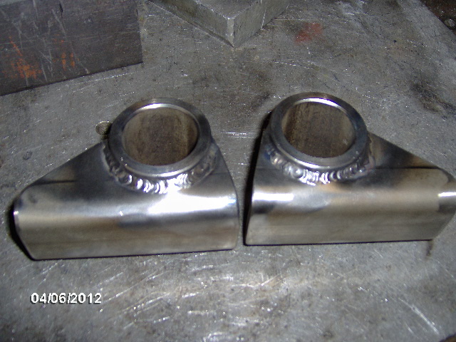

On Friday I needed to go back up to Fab Mecca and get the shackle hanger parts that I had forgotten on Wednesday, and it was also a good chance for me to go get some blood drawn for my annual physical. I had hoped that the guy with the Jeep wheels would call, since I was going to be in that neighborhood and I even stopped and had a leisurely breakfast to kill some time, but no luck. So off in the other direction toward work to get something done. But first a little prefab snack.
Sanded the pickling treatment off of the shackle hanger sleeves.
90420 90421
And, after carefully centering the sleeves, started welding them in.
90422
Right in the middle of a bead, I got the call from the wheel guy. Another lap of southeastern CT commin' up. Times like these I wish I still had my little beater Sonoma (S10).
90426 90427
Not bad for $8 each x 5. They have quite a bit more back spacing than the Mojave rims (6 inches from side wall to hub face instead of 4-1/2) but that still leaves about 3/4 inch rolling around clearance which is plenty for building purposes. Swung back by Fab Mecca to drop two of these off, since it was more or less on the way.
Back at work, here's the wire wheel set up.
90423 90424
And the Shackle hangers all welded up and wire wheeled.

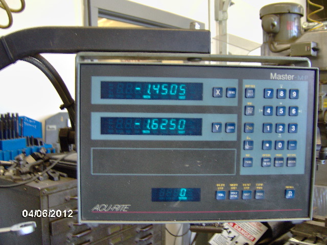

90428
at each point and drill a nice free fitting 5/8 diameter hole. (Must not have taken any pic's of the drilling and pile of metal chips.)
Oops, I missed one by half a thou... (tee hee)
Just needed to chase these same numbers around -/-, +/-, +/+ and -/+. Wash, rinse, repeat twice.
