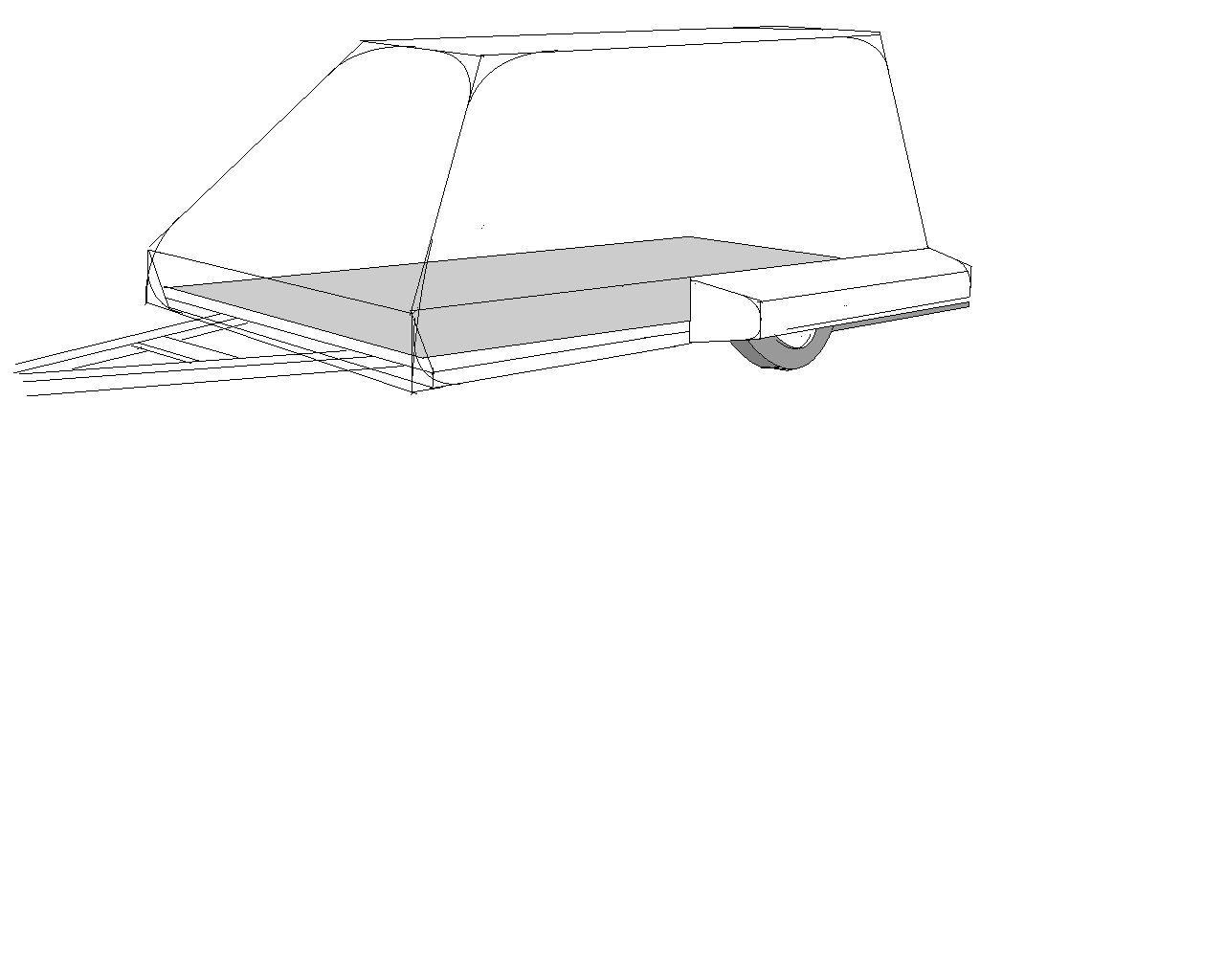

Postby GPW » Thu Oct 25, 2018 6:10 am
Now that we have the small boat trailer restoration underway … Attention now turns to the other trailer we have , the one originally intended for the FS , but now sitting in the verge …waiting … ( It’s a "Dilly” 54” wide frame ) . Big enough for a Zephyr , or something close to that … Still thinking about this design , trying to make it Cool looking but still practical ...
