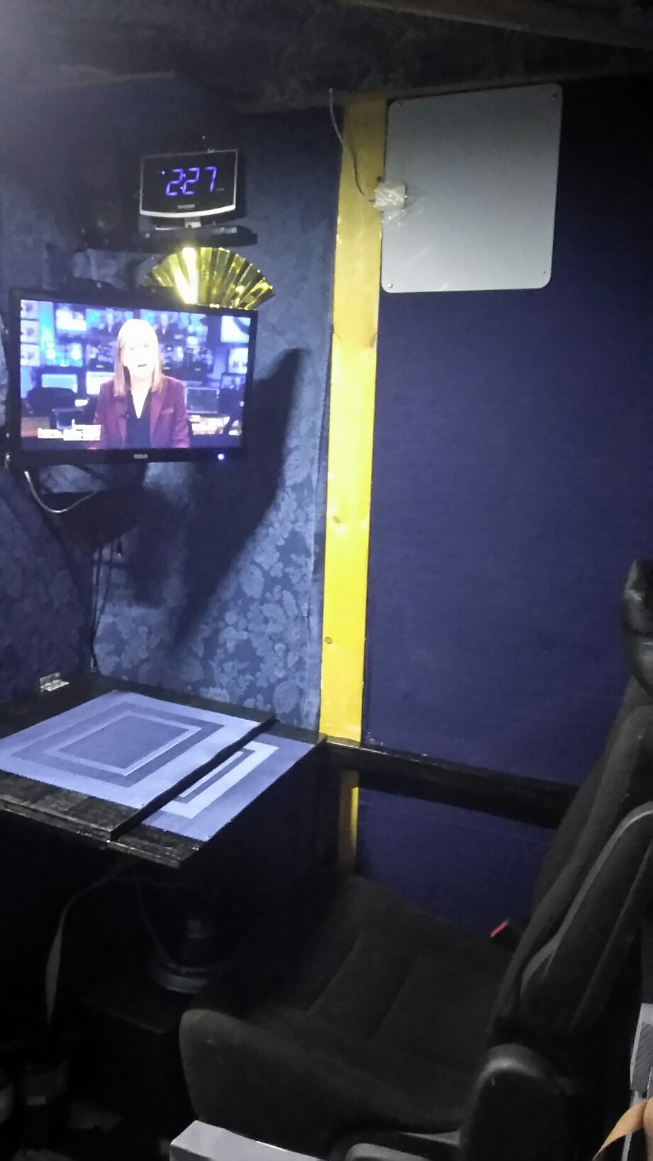

Decided to cover all the walls with textile material which I find gives a rich, textured finish. Went with deep colors for a soothing, "feel" inside. Blues will do that.
Used this glue which is latex based and working fine so far. Apply liberally and allow 2+ hrs to set. Lay up fabric over. Worked great with heavier drape fabric but will bleed through with lighter fabrics I found. Couple spots have to redo. All part of the learning process. :thumbsup:

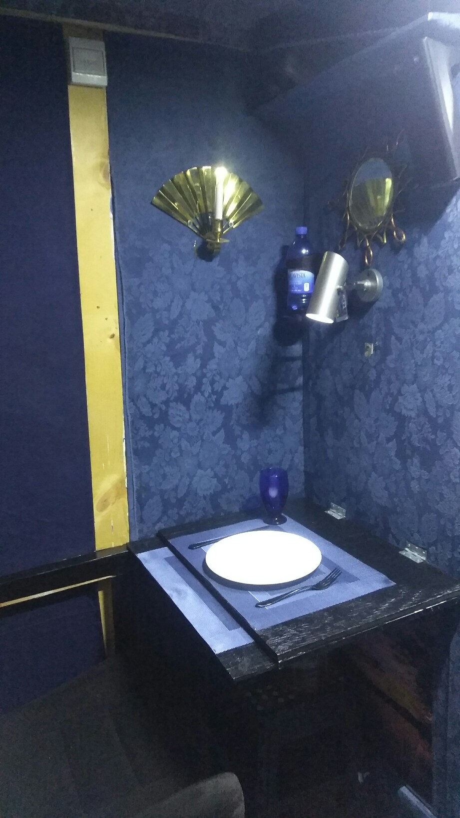

Dining area with spot lighting.

Entertainment and reading/computer area.

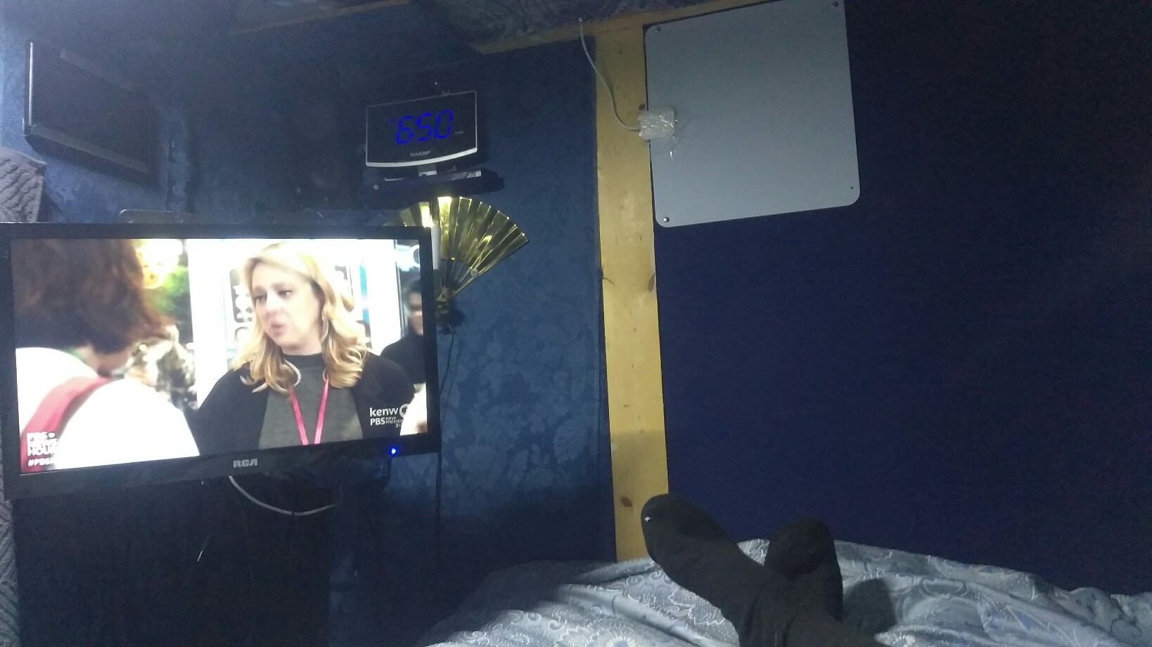

Lounge and recovery. Convert the rear seating area into bed mode.
Fold the recliners down, drop down the Murphy bed and :thumbsup:
Watching TV in bed is the ultimate evening relax mode.

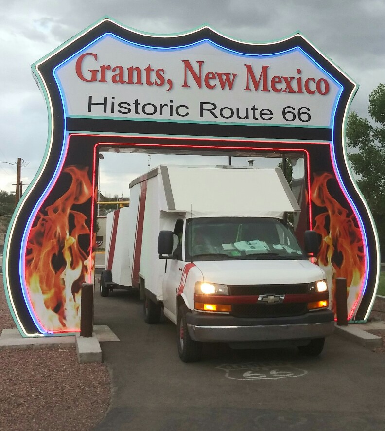

Postby Projector » Fri Nov 15, 2019 11:02 am
On the road :thumbsup:
There was a 10ft overhead that I luckily just fit under.

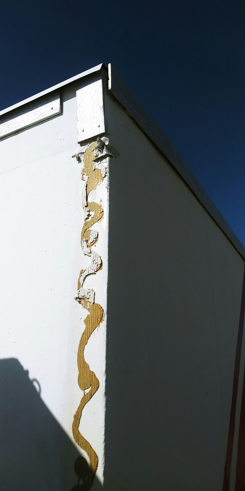

Design doesn't always meet practicality. In this case, it did 99% of the time. The gap between trailer and rig during turns was fine. Had two inches to spare. Tight tolerances and narrow gaps are a sign of design excellence and quality, right? :D
Except for the 1% when turning on too deep/steep ditch/entrance incline which narrowed the gap to BANG! :oops: contact. Rub strip knocked off and impact dent on the Styrofoam. But it was painless and I didn't feel a thing. :lol:
Managed to get a twin dent on the other back corner as well. Two for one deal. :shock:
Luckily it was just a two inches deep dent on four inch thick Styrofoam where the trailer top front roof hit the backside rig corner. Gave it a spanking. :cry:
Seems to me I could go about this a couple ways.
Chop off some of the back of the rig.
Extend the trailer hitch or the trailer tongue.
Or patch and pray. :worship:
Since I've done allot of praying with my rig, decided upon more of the same. ;)
Smooth a bit, glue, paste on new patch section. More glue over the patch, dry and paint. Not pretty but will do for now.
Increased the gap by removing rub strips and reducing trailer rig overhang.
Will see how that goes.

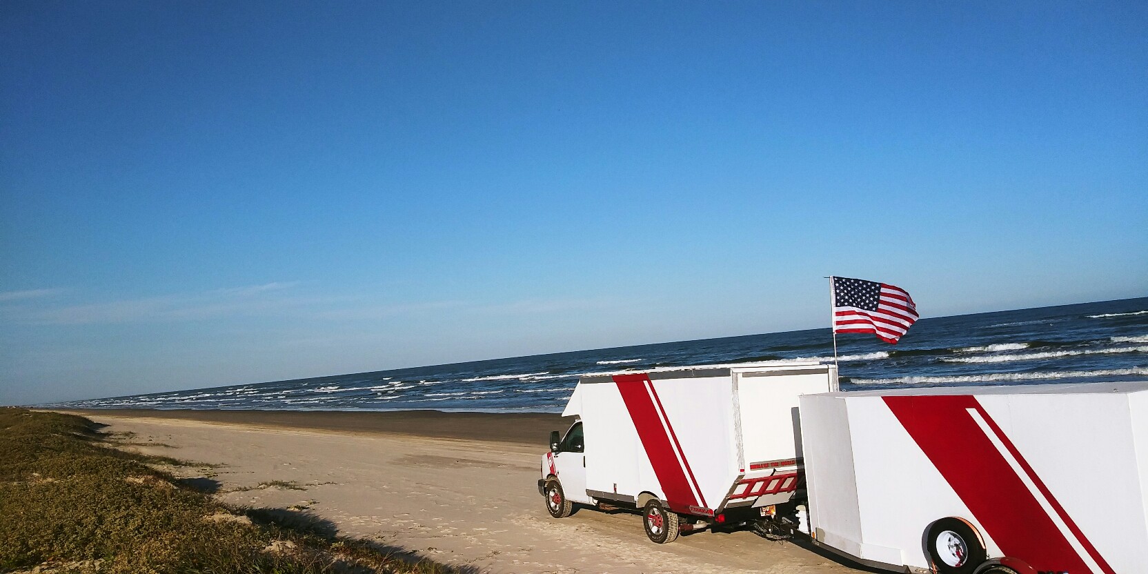

Postby Projector » Thu Jan 16, 2020 3:25 pm
Unofficial coast guard watch at the beach with sunset special.

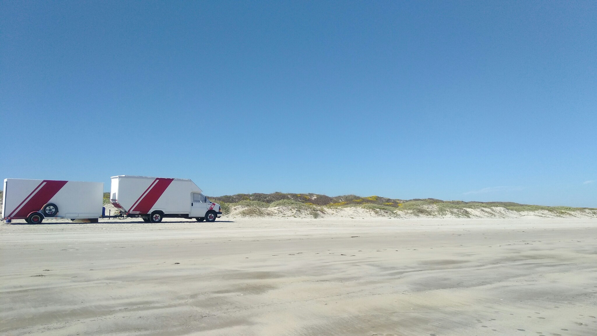

Re: TERRA6, Van cab and chassis 7*14, 4" Polystyrene
Postby Projector » Fri Feb 21, 2020 7:23 pm
Still in one piece, warm, toasty and dry.
