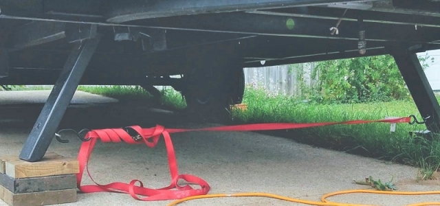

For stabilizers I made these ones below, similar to valterra stabilizers idea. There are lots of videos of "diy rv stabilizers" on the net. These ones seem to work good, almost no rocking now, just a bit more work to put them up comparing to commercial lead screw action bolt-on units.
I had to modify the design by adding a cross piece due to my frame configuration, which actually added stability as well.
Happy camping!
