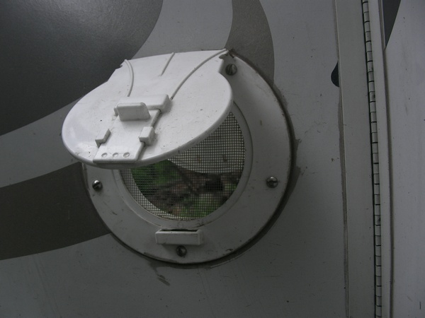

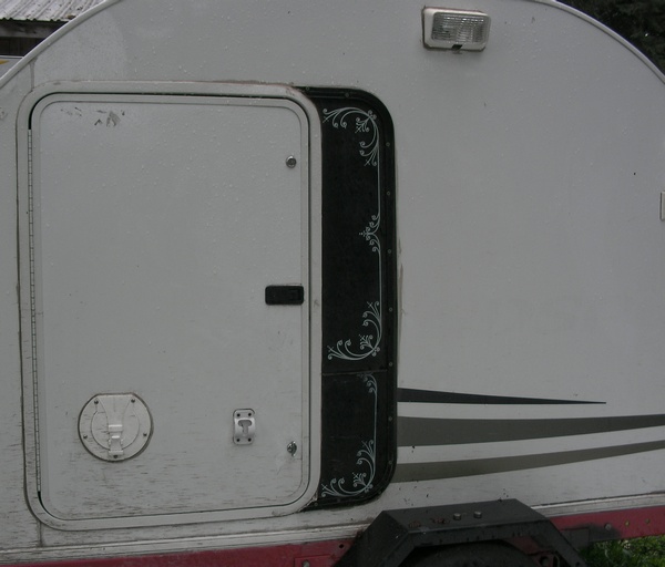

Here's what I did before our most recent trip and i'm happy to say
that they worked out very well in all weather conditions.
I put the same port/flap on both inside and outside of each door.
A piece of screen is sandwiched between.
The fresh air right in my face while sleeping was just what i wanted.
These vents seem to be the perfect size for draw for the
roof vent when cracked open on cold nights. (on warm nights we
leave one or both doors open.)
I'd love to see somebody improve on this.

do you have any more info on that first pic? is this yours? i like it. do you know how big it is?

eagle, yes this is my camper.
these things are called "rv access hatches" or something like that.
i got them on ebay.
the inner diameter of the port is 3.5".
i think hole i cut out of the door was about 4".
the total width is 6".
Conestoga

Conestoga wrote:eagle, yes this is my camper.
i got them on ebay.
nice, then you just added the screen when you bolted them in?
I like it.

swampjeep, yes exactly. i cut a round piece of screen about 6" diameter
and pretty much wrapped it around the inner side of one of the vents.
then i pushed that in the hole. i shoved the second vent into the other
side of the door. then bolted them together and sealed with caulk.
