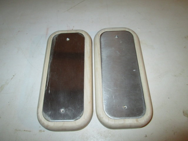

I am content to keep working on wood trim for the lights and switches, since I can't glue or apply polyurethane in this weather.
I chiseled out the curb side switch plate spacer. See if you can spot the discrepancy between the two. Karl figured it out before I even pulled the protective film off.
Hint: the grain of the brushed finish on the stainless plates does not agree, they should both be running across the short way (top to bottom). Not that big of a deal, we'll just fire up the time saver and regrain them both so they match (Karl spotted it so he offered to help fix it :R ).

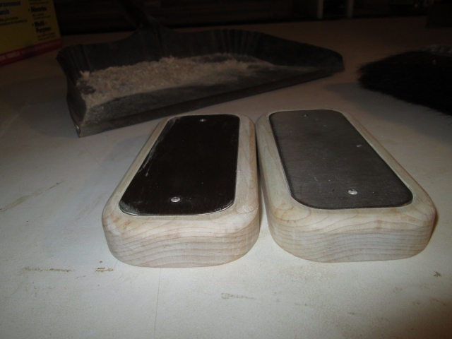

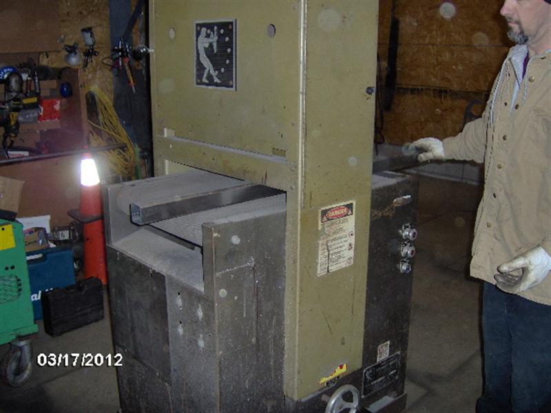

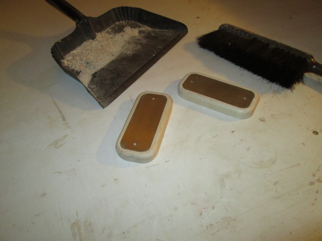

The time saver,
... a really big sander (like a planer) with the correct grit belt (a really big/wide belt) will put the finish true. We may need to adhere the switch plates to something a little thicker, but that is no problem. Doing it by hand would not give the same uniform effect.
Karl deals with this decorative stuff all of the time and he knows all of the tricks... and that's why he noticed it first! As you can see in the pic's, there is a little smudging from sanding the corners round and the heat that put into the plastic film, but that is pretty typical.

Postby oakinteriors1 » Wed Dec 18, 2013 7:20 pm
Oh My Gosh an Old Time Saver Wide Belt Sander....Those and Ramco sanders from the 80's..
I don't know what the big shops use now, being on my own so long...Mine is a 38'' woodmaster drum sander.....

Postby KCStudly » Wed Dec 18, 2013 7:37 pm
Thanks for chiming in, Oak. I can't say what a modern shop would use, but I know that Karl sought out the Time Saver, perhaps because he had prior experience with one(?). I think he may have mentioned to me what the advantage was to him, but I don't seem to recall at the moment (perhaps the belt lasts longer than the drum when working metal instead of wood?). If I think of it I will ask him the next time I see him.
