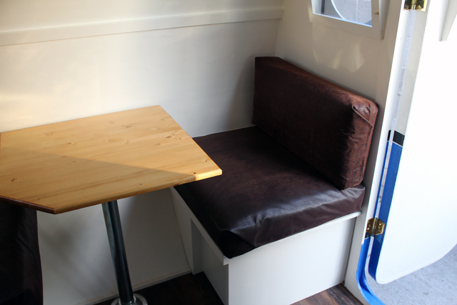

My wife made cushions but wrapping egg crate foam in fabric and using hot glue to hold the seams together. It was actually a measure of last minute desperation because we were trying to get out of town to go camping. They have help up amazingly well. If they keep holding up, I don't see a reason to change them. I like the fabric. It looks like leather but it is very soft cloth. The cushions that make up the seat back have imprinted designs but they don't show up in the picture.

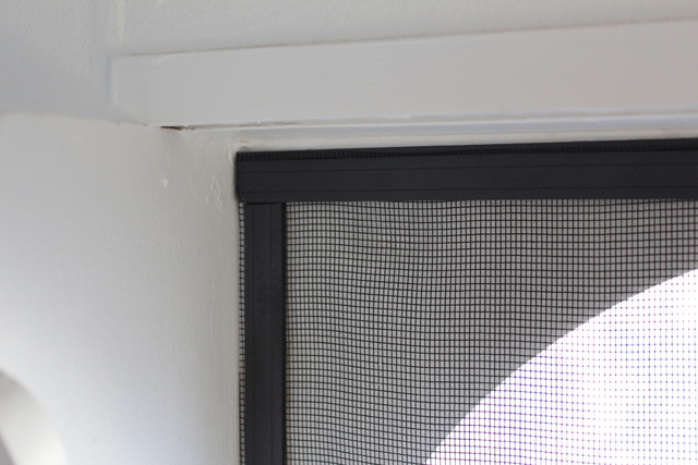

I decided to use flexible magnets to hold the screens for the windows in place. First I cut and glued a strip of magnet all around the window frame. Then I placed the screen on top and added another magnet to sandwich the screen material. It works wonderfully.

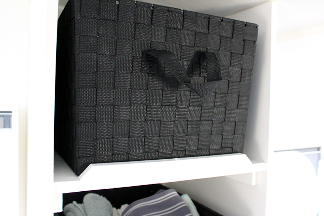

I made the shelf lips so that they were attached to the shelf by a single screw. This turned out to be a good thing because they were way too tall. Here is the shorter and much better version of the shelf lip.

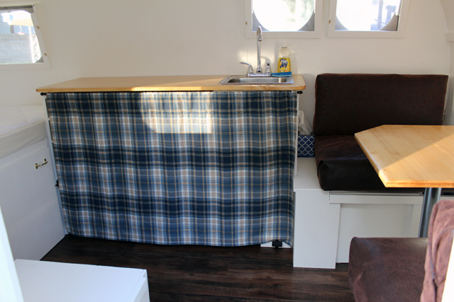

My wife made a curtain for the face of the galley counter. It easily slides out of the way and it helps to tidy up the appearance. Most of the time camping it is slid to the side with the sink.

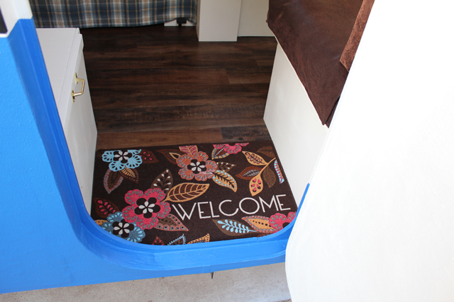

Welcome mat stores perfectly inside the door during travel. I wish I could say I planned that but it was just luck.

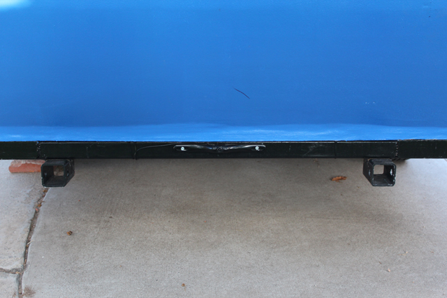

I installed a rear view camera. It really blends in with the bumper. It makes it so much nicer to back up and it eliminates the blind spot. I chose a wired camera because I didn't want to worry about interference issues. I'll try to get a shot of the screen in the cab of the truck next time I am hooked up. So far that has been $65 well spent.

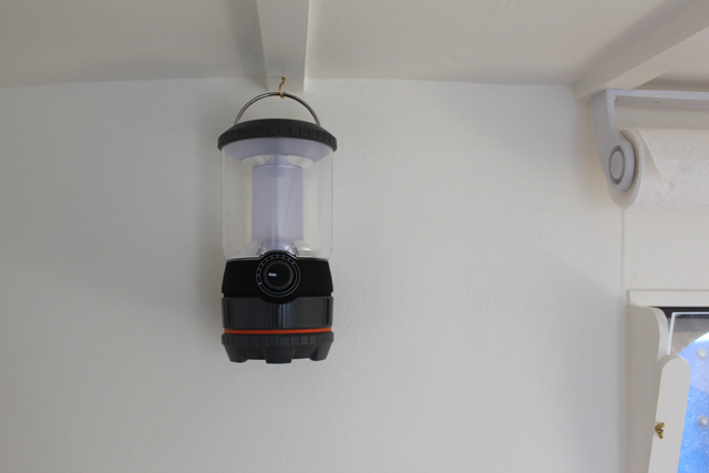

For lighting we bought this $30 LED lantern from Walmart. It puts out 500 lumens on high and that is actually too much for the trailer. Luckily, it is dimmable. I was going to hard wire lights into the trailer but the lantern works so well that I don't see the point. Plus you can take it off the hook and take it outside. It's the best $30 I have spent in a while. You should get one just to have around. It's a great light and the bang for your buck is hard to beat.
