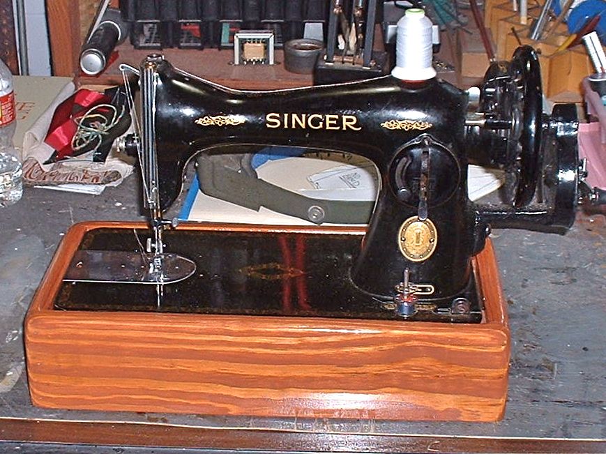

I look at how much material I was pushing through the little 1954 Singer and how easy to fold/roll ripstop would have been. When I mentioned it to my sister (how sews well) she said kinda the same thing as you. "Ripstop is a slippery little bugger." I guess each has it's own challenages!

I have a 1953 Singer HD Hand crank sewing machine … Works for all my needs …

Mine's treadle! I have one nicely developed calf now... Oh and my rhythm has improved! 8)
