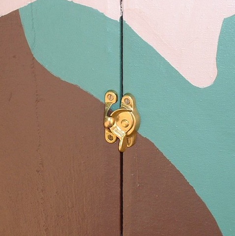

Postby GPW » Mon May 23, 2011 5:40 pm
My Fancy Door catch ... I Had it ... seems to work fine .... for now ... Image

Postby eaglesdare » Mon May 23, 2011 6:24 pm
:applause: looks great. but no locks?

Postby mikeschn » Mon May 23, 2011 6:58 pm
eaglesdare wrote::applause: looks great. but no locks?
I don't think GPW is stashing his silver in there. (He sold it 2 weeks ago just before it tanked!)
Just kidding.
My thoughts, GPW needs to find a way to lock it.

Postby GPW » Mon May 23, 2011 7:17 pm
This was just a "temporary " solution , till I can get to the Hdwe. store ... Have to go into town for that ... Actually leave the House ... :o Thinking of a padlock and clasp like everybody else ... Simple !! This was to keep the door from blowing open and shut in the breeze... aggravating ... no damage .. quick and dirty fix .. :oops:

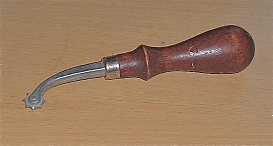

Postby GPW » Tue May 24, 2011 9:34 am
Still on a quest to find better adhesion with glue and foam .... I dug out this old tool that makes tiny perforations in the surface ... easily punctures many small holes in the foam ... Perfect for testing this concept before we purchase a standard perforating tool ... Just trying to make it Better !!! :thinking:

Postby Wobbly Wheels » Tue May 24, 2011 2:19 pm
GPW, is that a stitch spacer for working leather ?
I was thinking that some 36G floor paper glued to a paint roller sleeve might be just enough to stipple the surface...and it's cheap !
Not sure if it would bend that tight though...maybe glued to some 3" PVC instead....hmmm....
