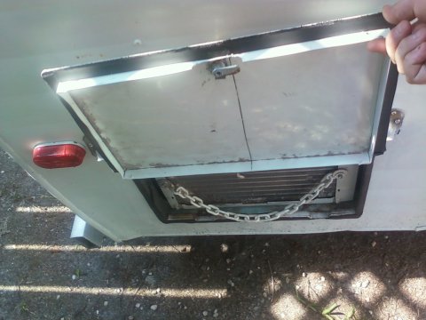

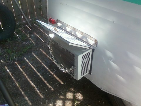

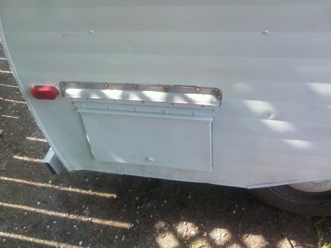

Postby 68galaxie » Tue May 24, 2011 3:53 pm
My AC on ball bearing slides
The reason I went with the rack mount slides is I can mount them on the bottom of the AC and don't have to worry about boxing the sides to mount drawer slides.
http://www.amazon.com/rackmount-3-secti ... B003M0H1AM
Load rating up to 145 Lbs

Postby mikeschn » Tue May 24, 2011 3:59 pm
I like it. I did something similar...

68G , Mike .... Those are EXACTLY what we need !!! :thumbsup: :thumbsup: :thumbsup: NICE !!!!
