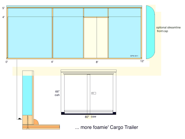

Postby GPW » Sat Jun 04, 2011 7:09 am
This is what I had in mind ... Pretty SIMPLE :o Working on an inside drawing like Rob's Cabin Car (bathroom and small tub/shower ... solar of course)

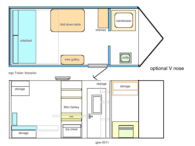

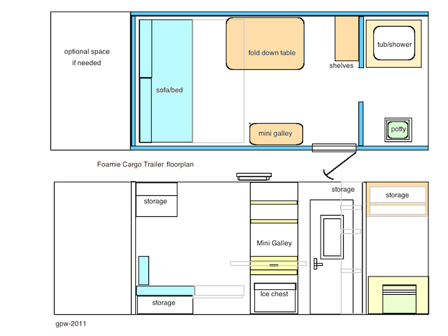

Postby GPW » Sat Jun 04, 2011 7:37 am
Here's the floor-plan idea ... Image
The inner structure would help support the "Box" as per previous discussions... Should be MUCH lighter than a tricked out standard CT.. Lower profile keeps it more aerodynamic... Should be easy to tow , even with a long one ... (optional) Already I'm thinking the Mini Galley could be where the "shelves" are ... Funny, we consider a 16' boat as small , but Big for a camper trailer ... Curious !!! :roll:
Postby GPW » Sat Jun 04, 2011 8:01 am
V nose option ... Image You could build it any size you wanted ... Just a box... :thinking:

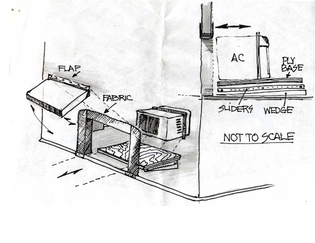

Postby GPW » Sat Jun 04, 2011 2:14 pm
So Hot I started thinking of the AC.... Here's a very rough sketch I made last night as to how the AC might go in ... same as everybody else ... NBD!!! Just trying to visualize how it goes together... Image
Thinking of adding a shelf crosswise across the front over the AC to help reinforce that area... and a place to put stuff , like my toaster oven and coffee maker ... ;)

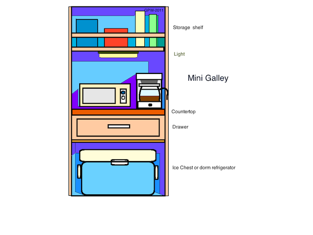

The cushions ... I lucked out on that ... perfect fit ... That was Cool , and made the wife happy too ... only because I got em' out the laundry room .. :roll: :lol:
Here's some more thoughts on a FCT Mini galley ... Image
Postby tinksdad » Sun Jun 05, 2011 9:16 am
GPW wrote:So Hot I started thinking of the AC.... Here's a very rough sketch I made last night as to how the AC might go in ... same as everybody else ... NBD!!! Just trying to visualize how it goes together... Image
Just my 2 1/2 cents worth. Like the idea of the wedge to aid in any condensation flowing downhill and out away from the trailer. A question though.... vibration when towing?? Would the a/c want to walk downhill and try to extend in transit or do you have plans for securing the tray in the closed position?
tinksdad
Posts: 966
Images: 155
Location: Olive Branch, MS
Postby 68galaxie » Sun Jun 05, 2011 9:29 am
The rack mount sliders I have a lock in the closed and the extended positions, very easy to release when ready
