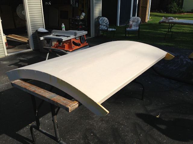

So, I'll bet you are wondering what I did today...

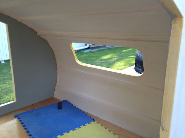

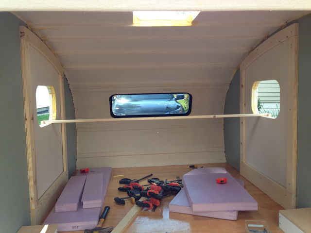

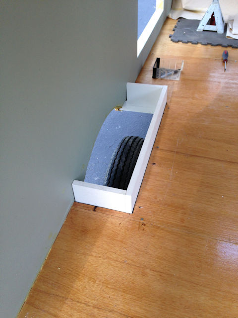

Well, first I built up the wheel wells...
Then I finished canvasing the inside...
Then I canvased the hatch...
I know it doesn't look like much, but it took 8 hours!!!

:thumbsup: it is progress, nice! BTW, how do you plan to protect the foam wall that is exposed to the wheel well inside?

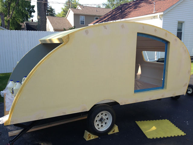

Another hard day, and it doesn't sound like we did much again.

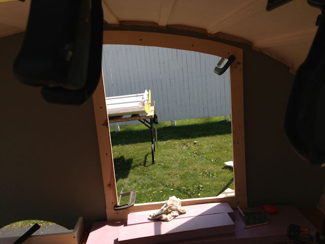

First of all, I framed in both doors. This took a ridiculous amount of time and energy. I was going to cut the top pieces on the cnc router, but opted to just do it with the jigsaw.
Here's another view of those frames, with the doors dry fitted...
We skinned the inside of the hatch. Since we ran out of canvas we used a piece of 8 oz canvas drop cloth from the orange box store.

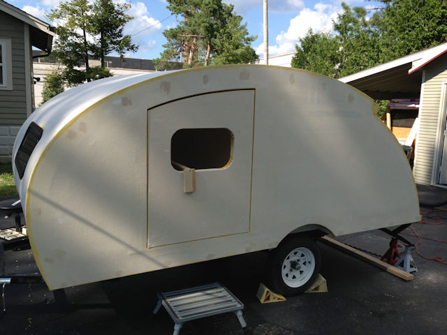

Finally, here's an outside view of the doors sitting in their new door frames.
I was hoping to start putting on the TBII on the outside, but I was too tired. So I'll start with the TBII in the morning.

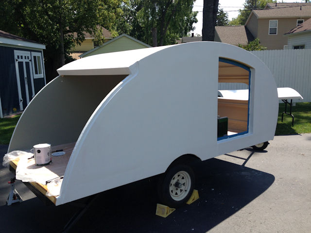

First coat of TBII is on all the exterior surfaces! Whew, it's going to be a hot one today, and humid too. Real Feel is going to be 91°.
Re: The Mad Dash begins...
Postby GPW » Sun Aug 16, 2015 10:11 am
let’s hope that was a well thinned coat to serve as a penetrating “sizing” .... that’s all you need , then primer and paint ...
Postby mikeschn » Sun Aug 16, 2015 1:34 pm
Put on a 2nd coat of TBII and then primed with Gripper! :D
Next, aluminum paint!!! 8)

Well, in spite of the heat, we got her painted. Wow, this is some interesting stuff, this aluminum paint. Tac was right, it's nice!
What do you guys think?
