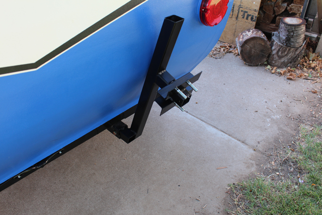

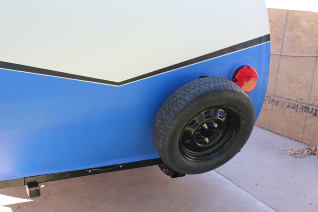

Here is a shot of the spare tire carrier and spare tire. Together they add another 46 lbs to the trailer. So we can just round it off and call it 1200 lbs. As far as I can tell, that is still light even for a pop up trailer. Even more than weight, I am happy that the trailer came out simple, functional and stylish. Those were really my 3 primary goals.

NM, 1200 lb. is pretty incredible , and you’ve got all your built-ins too ... :thumbsup: 8) :beer:
