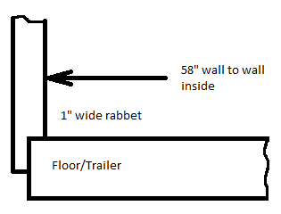

Postby Homebrewer25 » Tue Nov 14, 2017 9:01 am
Milliard makes a 6" tri-fold queen mattress that is 58" x 78". You could put a 1" wide rabbet the bottom edge of your foam sides and that would give you a 58" inside width.
wall to floor.png (2.52 KiB) Viewed 1176 times
https://www.milliardbedding.com/product/milliard-6-inch-memory-foam-tri-fold-mattress-with-ultra-soft-removable-cover-with-non-slip-bottom-queen-2/
