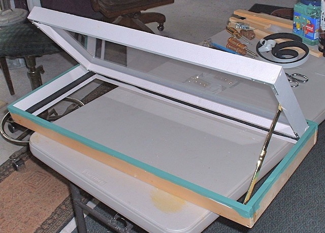

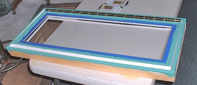

OK, here's the window pics :
You'll notice I left the masking tape on around the plexiglass so , once mounted , we can match the camo paint on the window frame ... I did save some of those colors for just such an occasion ...
