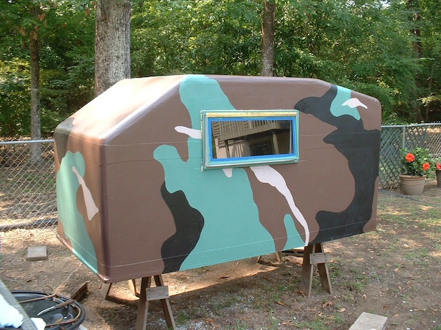

Here's the window glued in ... I just did like Big Mike did and took the saber saw to the opening ... nice and clean ... a little caulk , a little paint and we'll be done on the outside ... Just have to make a frame for the inner window opening as per usual ... :thumbsup: That was Quick... < 30min :D

now that is cool. :applause: no problem with cutting the canvas/foam?

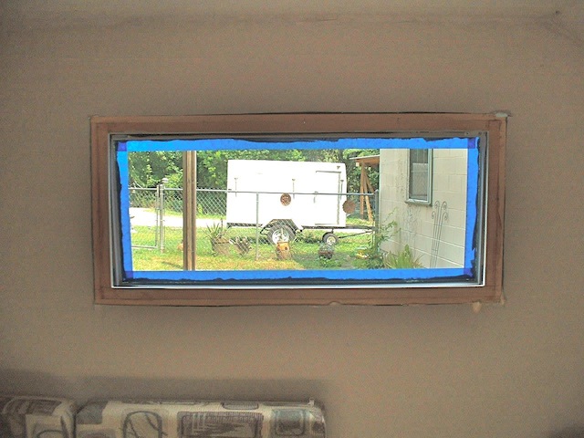

Here's the inside view ... Image
The inside of the frame is flush with the wall, the moulding will cover all the inner bits cleanly ... The outside of the window frame sticks out by 1/4" ... perfect for caulking ... and paint...
The foam /fabric cut Cleanly and easily ... Just like Mike said .... no scoring /measuring /drilling silliness... Quick and direct ... it didn't take two minutes to cut the whole opening , the (edit:) Jig saw just zipped right through it .. ;)

Postby GPW » Wed Jun 08, 2011 5:58 am
Adhesion test results .... After sitting outside in the very hot sun baking for a while I was concerned with how well the canvas stuck to the foam ... So after removing that block where the window is now , we tore the canvas from the foam .... It wasn't easy and it wasn't difficult , somewhere in between ... So now , I don't really worry about the canvas coming off .... It's stuck pretty well on the sanded foam ... Still wondering what a perforating tool would add to the adhesion ? There was No tearing out of the foam , the glue separated cleanly, but not easily ... Just thinking we can get the canvas to stick even better ... It does stick Very well to the ply floor ... and to itself ... That just doesn't want to come off ... at all ... Thinking on the Next Foamie . I'll get a perforating tool and try that ... Just trying to make the Best Foamie possible ... anybody else got a better idea ???
