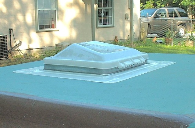

Got the Eternabond tape on the vent ! Gee Whiz!!! Is that stuff STICKY !!! :o Once it touches anything , don't plan on moving it ... Figuring this stuff should be good .... forever... Image
Not the prettiest , but nobody will be looking at the roof anyway ... :roll:

i have read about that eternabond tape. but i have not seen it locally. where did you get yours? can you buy it at lowes?
i have read good things about it and would love to use the double sides stuff, i can see where that would come in handy.
and i think your tear is perfect! the only thing i see wrong, is the top is not painted yet! :lol:

Got that tape for my Big TT so I don't have to depend on the (your word here) cheap caulk they use on RVs ... which must be replaced yearly at great expense if I had a dealer do it ... ($1200.00) On commercial RVs units , they use the worst/cheapest materials and even a little leak (unlike a Foamie ) can be totally Disastrous!!! :o Ridiculous ... I got mine at a local sheet metal roofing place , cheaper than on the internet and the old guy running the place gave me a demo , and showed examples of roofs he used it on with Great Success... for years .. Naturally I bought too much , so this is a great place to use it .... Easy , but STICKY STUFF
I did as per directions , give the area a quick swipe with a paper towel with Acetone on it... gotta' be real careful , Acetone melts Foam in a heartbeat ...so I had to be Quick and Light ... Worked ... and now it's about to rain again ... no worries , I'm sealed ... :thumbsup: 8) :D

Eagle , what I got was Eternabond Roofseal White 4" X 50' RSW-4-50 Paid like 70 bucks for Two rolls ... Way more than what I needed , but I'll find a use for it ... :thumbsup: BTW , didn't get the metal roller for it , I just used a big Spoon ... burnished it down ... Not going anywhere now... :D

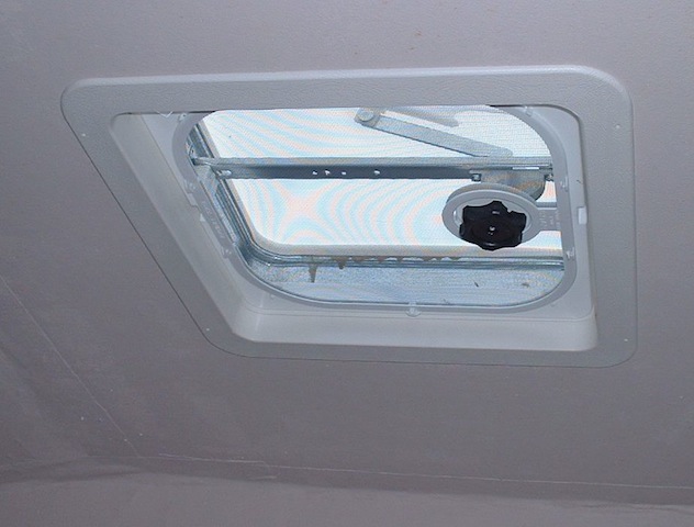

Got my "garnish" ring for the Foamie ($6.27) ... Fit perfect ... What luck !! Image

GPW wrote:Got the Eternabond tape on the vent ! Gee Whiz!!! Is that stuff STICKY !!! :o Once it touches anything , don't plan on moving it ... Figuring this stuff should be good .... forever... Image
I think you have that mounted the wrong way. You'll probably need to take the tape off and turn it 180 degrees...

Mike ... WRONG WAY !!!! EEK !!!! :o :o :o :shock: :shock: :? :? :?
  walls to floor ..... probably not !!! But maybe ??? it's STICKY alright but flexible ... Thinking the glue way would be the best ... :thinking: But you're keyed in .. glue would be great for that .. :thumbsup: Maybe try some of the "structural" foam glue in a cartridge ... May be even Stronger than the Gorilla glue ... ???

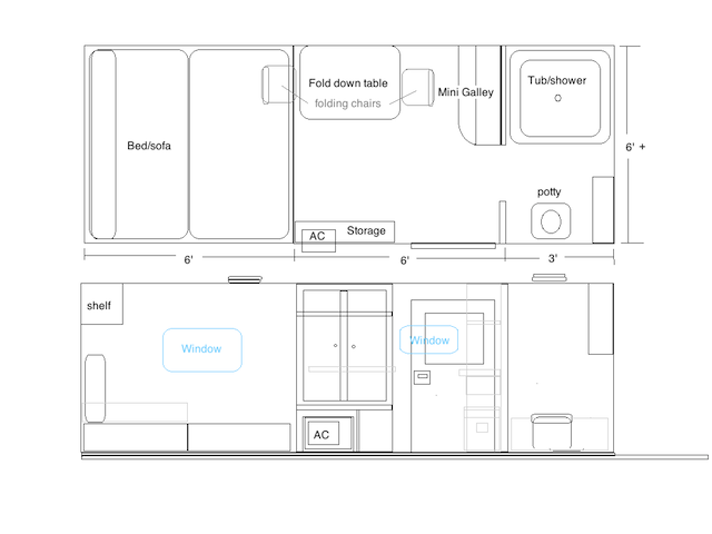

Still thinking about a BIG Foamie Camper Trailer done in the simple "Cargo Trailer " style ...
Here's a drawing that comes out @ around 15- 16' long , 6'+ wide on the inside ... and it would easily fit on a decent boat trailer ... Many still available here for a pittance ... (16' would allow use of the full length and width of the Foam sheets , and paneling ) Image
Bigger, more expensive , but less than a commercial CT , and probably a lot less weight ... ensuring an ample gear (Read: Beer) carrying capacity ... This one would use the paneling/ thin ply on the inside walls for more strength .. just more crumbs for thought ... :thinking: At first I thought 16' was kinda' HUGE , till I went outside and sat in my boat ... (16') A boat that long is really Not so big ... :o My old Canoe was that long ... :o
The second drawing (Album) is sort of a bill of materials and a layout guide ... pallet of Foam is now looking like a good investment ... :lol:
