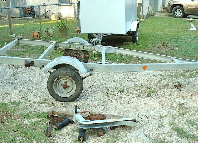

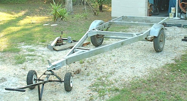

Got a few pics of the trailer prep , shortened and all the nasty stuff removed ... Image
First thing was to wire brush the flux off the welds on the coupler , and then a bit of Rustoleum primer over them ...
Trailer is nasty old Galvanized , wonder if it would hold paint .. the surface being so old ... ???

GPW wrote: Trailer is nasty old Galvanized , wonder if it would hold paint .. the surface being so old ... ???
You asking us about paint........ Huh :?

Eagles, that is indeed me who's going to want to pull his trailer through the seven rings of hell so my biggest concern is keeping it light enough it doesn't tear itself apart and stiff enough that the corners don't open up.
GPW, it's been a while since I painted over galvanizing, but I think the trick was to use the galvanizing primer as the transition coat then the paint. If you are adding any supports, I assume you know the gases from welding that stuff are particularly nasty ?

Postby GPW » Mon Jun 13, 2011 8:40 am
Just never painted over OLD galvanized finish before ... Had no call too ... Thinking the old Vinegar/lemon juice trick might work .. ??? Just an acid mordant ... :thinking:
Postby squatch » Mon Jun 13, 2011 10:12 am
My opinion on old galvanized is that it looks great. It's not rusted so it looks great. Here in the rust belt anything that's not rusted looks great!
I've got 2 old galvanized boat trailers. They look a little chaulky but no rust suits me fine. Most of the primers for galvanized metal no longer exist in the consumer world. You might just get some spray on cold galvanizing compound in a can to refresh the look a little. Hit it with a scotch bright and some mineral spirits 1st. I know the big box stores sometimes sell paint for old chain link fences. That might work as well.
squatch
Posts: 50
Joined: Sun Jun 05, 2011 12:44 pm
Location: Md
Postby GPW » Mon Jun 13, 2011 11:49 am
SQ, Thanks ... may just clean it up ... That's EASY ... :D
