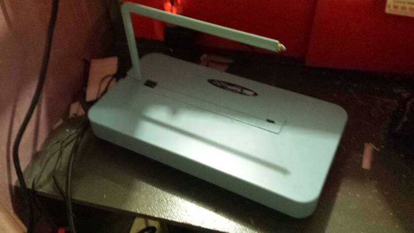

Gotta put this up. I bought this hot wire cutter at Hobby Lobby for $35. It's made for pretty light craft foam so I thought I would tear it up and have to return it after one cut, especially since they didn't have any replacement wires for sale. But it worked like a hot knife through butter. I only used one wire (it did come with 3) to do all of my curves. The unit does come out of the base which is how I mostly used it. I highly recommend it.
